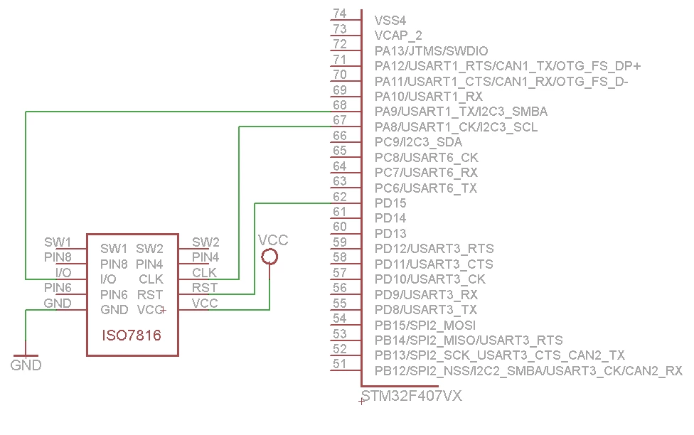

Connect STM32F4 with smart card ISO7816
Hi, everybody. My task is to connect STM32F4 discovery Board with Smart Card ISO7816. I don't use interface ST8024CDR only hooked paid directly by the scheme specified in the image:0690X000008ANWeQAO.png
I tried to adapt the Cubex project to STM32F1xx-EVAL. ATR reception does not work. The oscilloscope shows that the I/O port from the map is something similar to a sawtooth signal, but more flat (on three different maps it is different). So I guess it's still an ATR.
The configuration of the UART and frequency:

static void MX_USART1_SMARTCARD_Init(void){
 /* USER CODE BEGIN USART1_Init 0 */
	__HAL_RCC_USART1_CLK_ENABLE();
 /* USER CODE END USART1_Init 0 */
 /* USER CODE BEGIN USART1_Init 1 */
	/* USART Clock set to 3,5 MHz (PCLK2 (84 MHz) / 24) */
 /* USER CODE END USART1_Init 1 */
 SmartCardHandle.Instance = USART1;
 SmartCardHandle.Init.BaudRate = 9408;	 /* Starting baudrate = 3,5MHz / 372etu */
 SmartCardHandle.Init.WordLength = SMARTCARD_WORDLENGTH_9B;
 SmartCardHandle.Init.StopBits = SMARTCARD_STOPBITS_1_5;
 SmartCardHandle.Init.Parity = SMARTCARD_PARITY_EVEN;
 SmartCardHandle.Init.Mode = SMARTCARD_MODE_TX_RX;
 SmartCardHandle.Init.CLKPolarity = SMARTCARD_POLARITY_LOW;
 SmartCardHandle.Init.CLKPhase = SMARTCARD_PHASE_1EDGE;
 SmartCardHandle.Init.CLKLastBit = SMARTCARD_LASTBIT_DISABLE;
 SmartCardHandle.Init.Prescaler = 12;
 SmartCardHandle.Init.GuardTime = 16;
 SmartCardHandle.Init.NACKState = SMARTCARD_NACK_DISABLE;
 if (HAL_SMARTCARD_Init(&SmartCardHandle) != HAL_OK)
 Error_Handler();
	__HAL_SMARTCARD_ENABLE(&SmartCardHandle);
 /* USER CODE BEGIN USART1_Init 2 */
	HAL_SMARTCARD_Init(&SmartCardHandle);
	SC_RESET(GPIO_PIN_SET);
 /* USER CODE END USART1_Init 2 */

Trying to read directly:
HAL_GPIO_WritePin(GPIOD, GPIO_PIN_15, GPIO_PIN_RESET);
HAL_Delay(500);
HAL_GPIO_WritePin(GPIOD, GPIO_PIN_15, GPIO_PIN_SET);
convention=HAL_SMARTCARD_Receive(&SmartCardHandle, atr_buff, atr_size, 500);
HAL_Delay(12);
/* Insert delay of 20ms for signal stabilization */
HAL_Delay(300);
PD15 - Reset.
I always get zeros. What could be the problem?

If anyone is interested, the problem is solved very simply. I used USART3 instead of USART1 and everything was considered successful.
