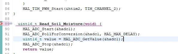

I'm trying to make a smart irrigation using stm32f407 so, i used a Soil Moisture Sensors
i write my code but when i trying to run the problem is :Description Resource Path Location Type conflicting types for 'Read_Soil_Moisture'; have 'uint16_t(void)' {aka 'short unsigned int(void)'} main.c /Projectrrr/Core/Src line 89 C/C++ Problem
and this is my code:
so how i can solve this problem

Please use this button to properly post source code:
Please post the full text of the message - copy from the 'Console' window, and paste here.
The full message should tell you both what type it was expecting, and what type it actually got - you've only posted the bit saying what it's got.

#include "main.h"
// Function prototypes
void Error_Handler(void);
static void MX_ADC1_Init(void);
static void MX_TIM2_Init(void);
ADC_HandleTypeDef hadc1;
TIM_HandleTypeDef htim2;
int main(void) {
 HAL_Init();
 SystemClock_Config();
 MX_GPIO_Init();
 MX_ADC1_Init();
 MX_TIM2_Init();
 while (1) {
 uint16_t moisture_level = Read_Soil_Moisture();
 if (moisture_level < 2000) { // Example threshold
 Control_Servo(90); // Open valve
 } else {
 Control_Servo(0); // Close valve
 HAL_Delay(1000); // Delay for 1 second
void SystemClock_Config(void) {
 // System clock configuration code (auto-generated by STM32CubeMX)
static void MX_GPIO_Init(void) {
 // GPIO initialization code (auto-generated by STM32CubeMX)
static void MX_ADC1_Init(void) {
 ADC_ChannelConfTypeDef sConfig = {0};
 hadc1.Instance = ADC1;
 hadc1.Init.ClockPrescaler = ADC_CLOCK_SYNC_PCLK_DIV2;
 hadc1.Init.Resolution = ADC_RESOLUTION_12B;
 hadc1.Init.ScanConvMode = DISABLE;
 hadc1.Init.ContinuousConvMode = DISABLE;
 hadc1.Init.DiscontinuousConvMode = DISABLE;
 hadc1.Init.ExternalTrigConvEdge = ADC_EXTERNALTRIGCONVEDGE_NONE;
 hadc1.Init.ExternalTrigConv = ADC_SOFTWARE_START;
 hadc1.Init.DataAlign = ADC_DATAALIGN_RIGHT;
 hadc1.Init.NbrOfConversion = 1;
 hadc1.Init.DMAContinuousRequests = DISABLE;
 hadc1.Init.EOCSelection = ADC_EOC_SINGLE_CONV;
 if (HAL_ADC_Init(&hadc1) != HAL_OK) {
 Error_Handler();
 sConfig.Channel = ADC_CHANNEL_0;
 sConfig.Rank = 1;
 sConfig.SamplingTime = ADC_SAMPLETIME_3CYCLES;
 if (HAL_ADC_ConfigChannel(&hadc1, &sConfig) != HAL_OK) {
 Error_Handler();
static void MX_TIM2_Init(void) {
 TIM_OC_InitTypeDef sConfigOC = {0};
 htim2.Instance = TIM2;
 htim2.Init.Prescaler = 83;
 htim2.Init.CounterMode = TIM_COUNTERMODE_UP;
 htim2.Init.Period = 20000 - 1;
 htim2.Init.ClockDivision = TIM_CLOCKDIVISION_DIV1;
 htim2.Init.AutoReloadPreload = TIM_AUTORELOAD_PRELOAD_DISABLE;
 if (HAL_TIM_PWM_Init(&htim2) != HAL_OK) {
 Error_Handler();
 sConfigOC.OCMode = TIM_OCMODE_PWM1;
 sConfigOC.Pulse = 1500; // 1.5ms pulse width (90 degrees)
 sConfigOC.OCPolarity = TIM_OCPOLARITY_HIGH;
 sConfigOC.OCFastMode = TIM_OCFAST_DISABLE;
 if (HAL_TIM_PWM_ConfigChannel(&htim2, &sConfigOC, TIM_CHANNEL_2) != HAL_OK) {
 Error_Handler();
 HAL_TIM_PWM_Start(&htim2, TIM_CHANNEL_2);
 uint16_t Read_Soil_Moisture(void) {
 HAL_ADC_Start(&hadc1);
 HAL_ADC_PollForConversion(&hadc1, HAL_MAX_DELAY);
 uint16_t value = HAL_ADC_GetValue(&hadc1);
 HAL_ADC_Stop(&hadc1);
 return value;
void Control_Servo(uint8_t position) {
 // Convert position (0-180) to pulse width (1ms to 2ms)
 uint16_t pulse = (position * 1000 / 180) + 1000;
 __HAL_TIM_SET_COMPARE(&htim2, TIM_CHANNEL_2, pulse);
void Error_Handler(void) {
 while (1) {
 // Stay here...

Used it on line 21 and compiler guessed, you need a prototype or definition before first usage.
uint16_t Read_Soil_Moisture(void); // prototype first, and early

Lacking in contextual detail.
You've probably defined or used it earlier and the compiler used that.
Check .H files and any instance where you might have created a prototype or used it previously.

In line 21  Read_Soil_Moisture() called without previous declaration. Either move this  function up before main(), or add the prototype declaration after line 8.
