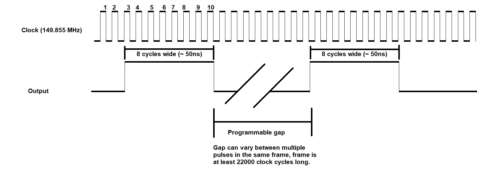

I am simulating another device that is supposed to send ground until it pulses high at certain points for 50 ns. These points are random but measurable.
> Do you want to trigger each pulse or send bursts of multiple pulses ?
I want to trigger at specific counts of the clock cycles. So the first pulse may start at 20 clock cycles, then the second would be 2000, then 50, etc.. The high portion of the pulse is 50 ns, or about 8 clock cycles, long.
> Do you want multiple identical pulses in a row or have each pulse potentially different ?
Each pulse is identical in the width of the high, but different in the width of the low.
> Is the exact number of pulse matter ?
Yes.
I have attached a picture of what I wanted to do. Basically, for at least 22000 clock cycles of a 149.855 MHz clock, the MCU would output a pulse of a high signal high for 8 cycles, then have a low signal of programmable, varying width. The number of high pulses and all low widths would be known ahead of time.

June 20, 2024
It is "pulse box".  Importatnt question is what is acceptable minimum gap between pulses ? If about 20 clock ticks (130ns) then it can be done by timer in PWM mode with reconfiguration its periody by DMA. If gap must be shorter, then you will not be able to reconfigure timer "in time" and you have to go harder way.
With SPI you are able to create any pattern with your clock granularity (6.6ns), but in some cases you need to be clever, especialy in case of high number of pulses and long pulse patterns. You have limited memory space and in "brute force" SPI mode you need 1bit for every clock cycle. 22000 cycles long gap takes 2.75kB of RAM and in case of high number of pulses you can run out of memory. In that case you have to choose clever method. Use CPU to interpret data and load them into SPI manualy. Few years back one our student do something similar on FPGA (with 1ns resolution) but his used principle can be done even on MCU.
BTW: If you need more resolution you can choose STM with HRtimer and you will get resolution up to 0.3ns
Be please little more specific... how many pulses ? And minimal needed gap ?
