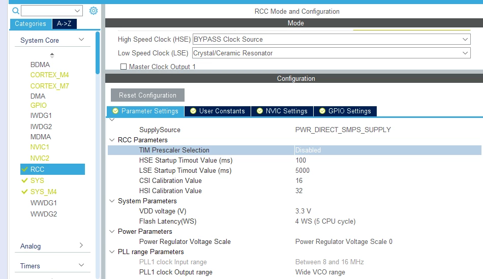

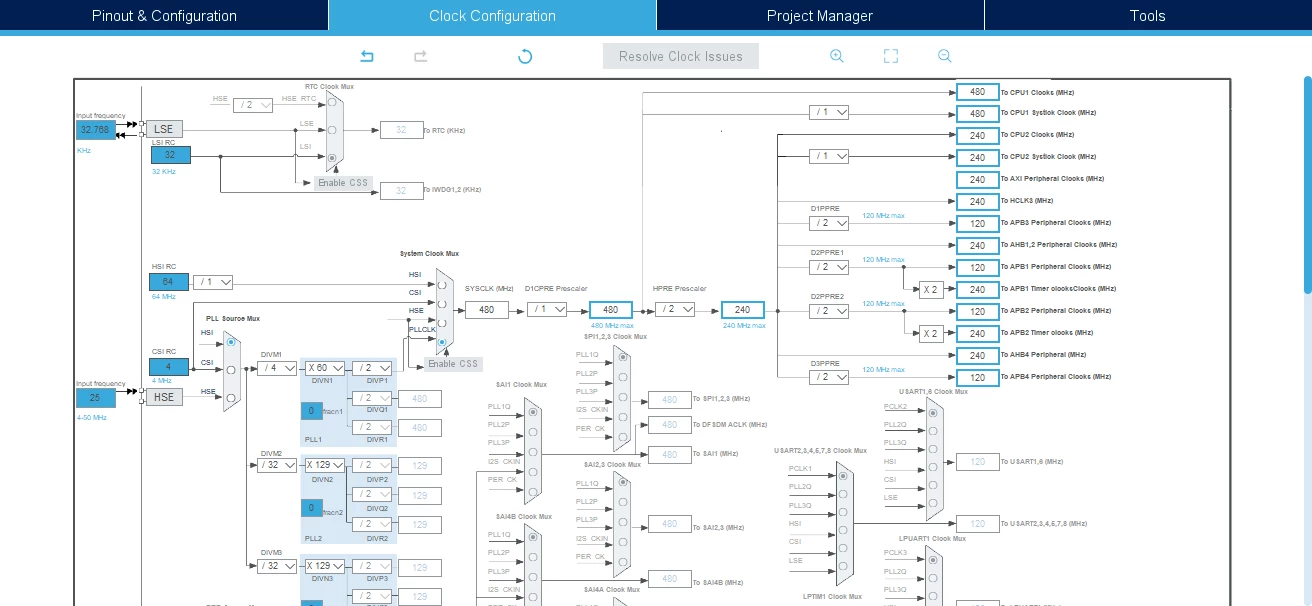

Configuring NUCLEO-H755ZI-Q at 480MHz

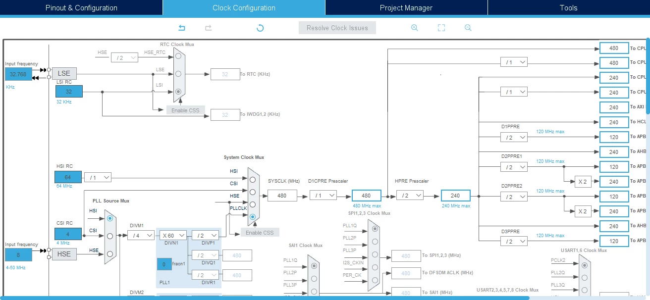

I'm trying to configure NUCLEO demo board at 480Mhz but I'm not able in any way, the following clock configuration seams to be correct, no conflicts

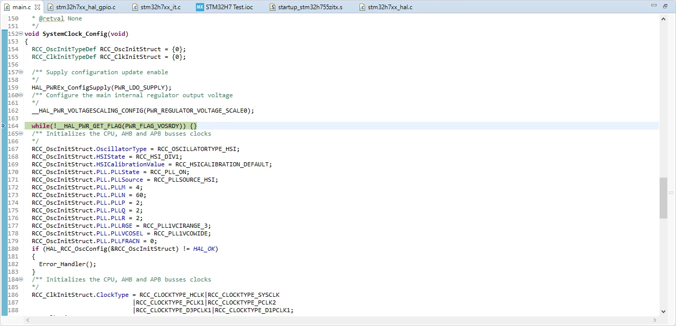

But the code will permanently hang on on the following configuration line
If I comment the line
while(!__HAL_PWR_GET_FLAG(PWR_FLAG_VOSRDY))
all seams to work correctly, why?

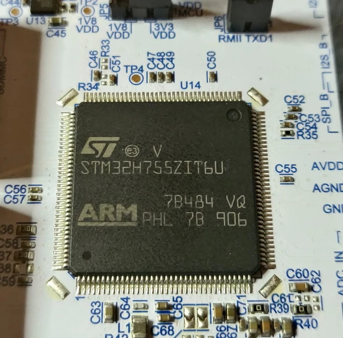

Chip revision seams to be V so It will be capable of 480MHz
What is wrong? Can someone post a correct clock configuration ? Is there a modify to the board to do? I'm using the last STM32CubeIDE 1.3.0 with H7 1.7.0 support library

I've got Y step parts that run >500MHz
Check if it is wired for a SMPS supply?
STM32Cube_FW_H7_V1.7.0\Projects\NUCLEO-H745ZI-Q\Examples\PWR\PWR_VOS0_480MHZ\CM7\Src\main.c
 /* The voltage scaling allows optimizing the power consumption when the device is
 clocked below the maximum system frequency, to update the voltage scaling value
 regarding system frequency refer to product datasheet. */
 __HAL_PWR_VOLTAGESCALING_CONFIG(PWR_REGULATOR_VOLTAGE_SCALE1);
 while(!__HAL_PWR_GET_FLAG(PWR_FLAG_VOSRDY)) {}
 __HAL_RCC_SYSCFG_CLK_ENABLE();
 __HAL_PWR_VOLTAGESCALING_CONFIG(PWR_REGULATOR_VOLTAGE_SCALE0);
GMG
GMGAuthor
Mar 1, 2020 9:01 PM UTC
Hi, I think you may be right, now the problem is that I can't find a working solution to go to 480MHz using IDE configurator
Board power configuration may be the default one as write in the user manual of the NUCLEO
Power Regulator Voltage Scale options can only be 0
The symptoms seem to be exactly those, but I don't understand how to solve it

Explorer
Feb 4, 2024 7:25 PM UTC
I know this is an old thread, thought I'd add a helpful tidbit. I had the darndest time getting the board to work at 480MHz, and when I got it (LDO, VC0) the board locked up when powering on. Once it was properly booted with a 240MHz build, I could flash the 480, and it would be fine until the next power cycle. So the solution is in the system clock startup, to start with the SMPS, then switch to the LDO. This worked on the stock Nucleo-H755ZI-Q board (rev V chip)
Use MX to configure for 480MHz (240MHz M4)(LDO, VS0), then in main.c, add:
/* USER CODE BEGIN Init */
// Start with SMPS before switching to LDO; necessary for 480MHz @ boot up
HAL_PWREx_ConfigSupply(PWR_DIRECT_SMPS_SUPPLY);
__HAL_PWR_VOLTAGESCALING_CONFIG(PWR_REGULATOR_VOLTAGE_SCALE2);
/* USER CODE END Init */

mƎALLEm
Feb 19, 2024 4:20 PM UTC
To all,

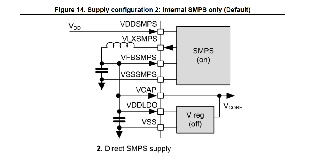

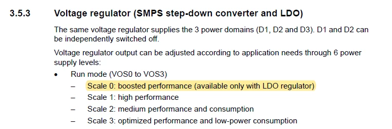

By specification VOS0 (480MHz max) can be reached only with LDO.
So no VOS0 with SMPS.
SMPS can reach up to 400MHz at VOS1:
Refer to the datasheet:
So with NUCLEO-H745ZI-Q the power configuration is SMPS => The max system clock is 400Mhz with this board except if you modify the board to be in LDO config.
