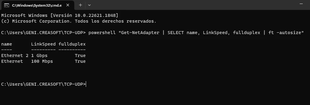

Sometimes when server is running link is detected as down. So we were debugging and checking MAC registers where PHY is putting their register values using the mdio interface (for status and control communications).
Observations:
1.- Autonegotiation result and MAC configuration:
When link up is detected and autonegotiation occurres it seems that PHY is detecting that mode is half-duplex, despite ethernet_init is forcing full-duplex mode. But register has on this bit the value of a half-duplex autonegotiation result. So, here we thought that -for some reason- LAN was only able to talk with the remote host by this mode. Despite this, system communications seems very quick. So we want to be sure and we asked Windows 11 for speed and mode ethernet cards connections. This was the answer:
  • Does this mean that LAN device is wrongly detecting "half-duplex" and LAN is configuring MAC driver for working in half duplex because of LAN register wrong value but ethernet communication between 2 hosts are actually full-duplex?

LCE
Principal III
Jun 22, 2023 6:37 AM UTC
About the half-duplex problem:
If you are using ETH HAL, maybe there is still the bug that HAL ethernet init is reading the wrong register from the LAN8742 to evaluate the negotiated settings. That was the case for me with an F7.
And if one side is setup wrong (PHY and host are working full duplex, but STM's MAC thinks it's half-duplex) strange things start to happen...
Here's my old comment:
/* PHY should be set up now, just check status of auto negotiation */

genisuvi
genisuviAuthor
Jun 22, 2023 9:07 AM UTC
 Thanks @LCE , I'm worried about this situation. MAC is completely wrong and it is thinking it's in half duplex when not. Even DMA ethernet descriptor status "duplex-mode field" says that it is half-duplex. ST is a great company and has devices used in a lot of electronics industry products. It's a big big fail! big and basic issue: to know which speed and duplex mode the link has!
You are right, the PHY_REG_SR is 10 and should be 1F on my config.h HAL file.
I have noticed another thing during MAC initialization, concretely when mcu talks with phy functions implementation:

LCE
Principal III
Jun 22, 2023 1:20 PM UTC
So, have you solved the half-duplex problem?
As soon as the STM's MAC gets the right answer from PHY and makes the right settings (full-duplex), it will probably work well.
I would not change the register's address, but rather add a new register for that address.

genisuviAuthorBest answer
Jun 23, 2023 9:54 AM UTC
@LCE yes it does, but I had to add more corrections. This register was wrong mapped, but duplex and speed bits mapping are wrong too. MACCR register now is "showing" full duplex. I did it and it was finally solved:
/* Section 4: Extended PHY Registers */
#define PHY_SR ((uint16_t)0x1F) /*!< PHY status register Offset */
#define PHY_SPEED_STATUS ((uint16_t)0x0002) /*!< PHY Speed mask */
#define PHY_DUPLEX_STATUS ((uint16_t)0x0010) /*!< PHY Duplex mask*/
#define PHY_ISFR ((uint16_t)0x001D) /*!< PHY Interrupt Source Flag register Offset */
#define PHY_ISFR_INT4 ((uint16_t)0x000B) /*!< PHY Link down inturrupt */
