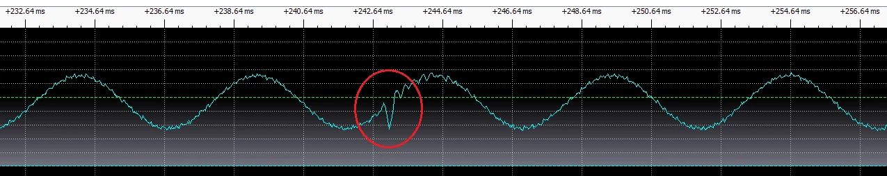

Hi - I'm attempting to interface a

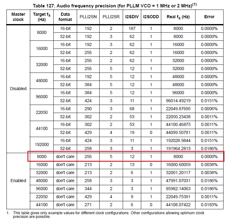

I've configured the STM32F429 I2S as 8 KHz output, using a master clock.  This configuration is shown in the table below:
By breaking during running the code, I've confirmed all of the I2S values shown in the table above (PLLI2SN, PLLI2SR, I2SDIV and I2SODD) match what I'm seeing in the RCC-PLLI2SCFGR and SPI-I2SPR registers.
I'm simply sending a single cycle of a sine wave (256 samples) from my STM32F429 to the PmodI2S.  My PmodI2S is connected to some basic PC speakers.  The audio coming from the speakers is good *EXCEPT* for random ''clicks'' that occur in the sine wave sound.
I've hooked the PmodI2S output up to an oscilloscope and see the ''clicks'' as shown in the example below:
The clicks appear to be random - they don't appear at any regular position in the sine wave cycle.
I'm stumped as to what to try next in attempts to get rid of these clicking sounds.  If anyone has any suggestions I would be very appreciative to hear them.  Thanks.

    I'm simply sending
    How simply?

    Ah, great question, Jan. Not sure why I didn't think of this but, if I assume correctly, you're suggesting there is possibly a lag in getting the data into the SPI data register, correct? I'm using a couple of HAL functions inside the program's infinite while loop as follows:
    while (1)
    if (HAL_I2S_GetState(&hi2s2) == HAL_I2S_STATE_READY)
    HAL_I2S_Transmit(&hi2s2, &SINE_TABLE[index], 1, 0);
    if(!channel) channel = 1;
    else channel = 0;
    if (channel)
    index++;
    index = index % 256;
    I've attached the entire code if you're interested in taking a look.
    However, I have to say, I'd be surprised if the HAL code was not able to handle transferring the data fast enough. I have no interrupts or any other processing occurring in this program. The while loop just infinitely sends data and the playback sample rate is only 8KHz.
    Possibly I need to offload the data transfer duty to DMA? I have not yet done DMA with this development board (STM32F4) I have done it with a different ARM Cortex-M4 board though (the Texas Instruments TM4C123G). I cannot use the TM4C123G for this though as it does not have I2S support. And I prefer this STM32F4 board anyway.
    Don't be surprised: benchmark (i.e. measure, how long it takes to execute the loop - toggle a GPIO and measure with an oscilloscope or LA).
    You run the system clock at a somewhat surprisingly low 25MHz, and you divide it to APB1 by 8. This, together with the lengthy 'library' code and no compiler optimization you might've used, may result in surprisingly long execution times.
    I don't say this is it. The codec you're using appears to be a quirky one, with clock autodetection, which may be another source of surprises if not driven in expected way.

    Jan - Thanks for the reply.  Good point about the clock speed.  I've tweaked this, increasing the clock speed to the 180MHz max and also reduced the APB1 divider to 4.  This resulted in a much higher pitch tone coming out of the speakers (unfortunately still distorted though).
    What surprises and confuses me about the change in pitch is that I DID NOT change the I2S sample rate.  It remains at 8 KHz.  With an increased CPU clock rate I figured transmitting the sample to the SPI DR would just block longer (when checking the SPI SR and seeing the TX buffer was still populated) and the output pitch would not change.
    This, along with various other tweaking and trial-and-error I've done - eluded to in my previous post, makes me wonder if I'm missing something about how I2S works on the STM32F4.
    I've (just now) managed to get a hold of a similar STM32 board (an STM32F411) that actually has an very similar DAC on the board itself and have an audio example from STM working on this board.  I'm going to dig through the code and fully understand how that works in hopes of it shedding some light on how to get the STM32F429 to work with the Digilent PmodI2S.

    You should observe the data output to I2S with a logic analyzer.
    I don't and won't Cube but IMO the timeout of 0 is not right.
