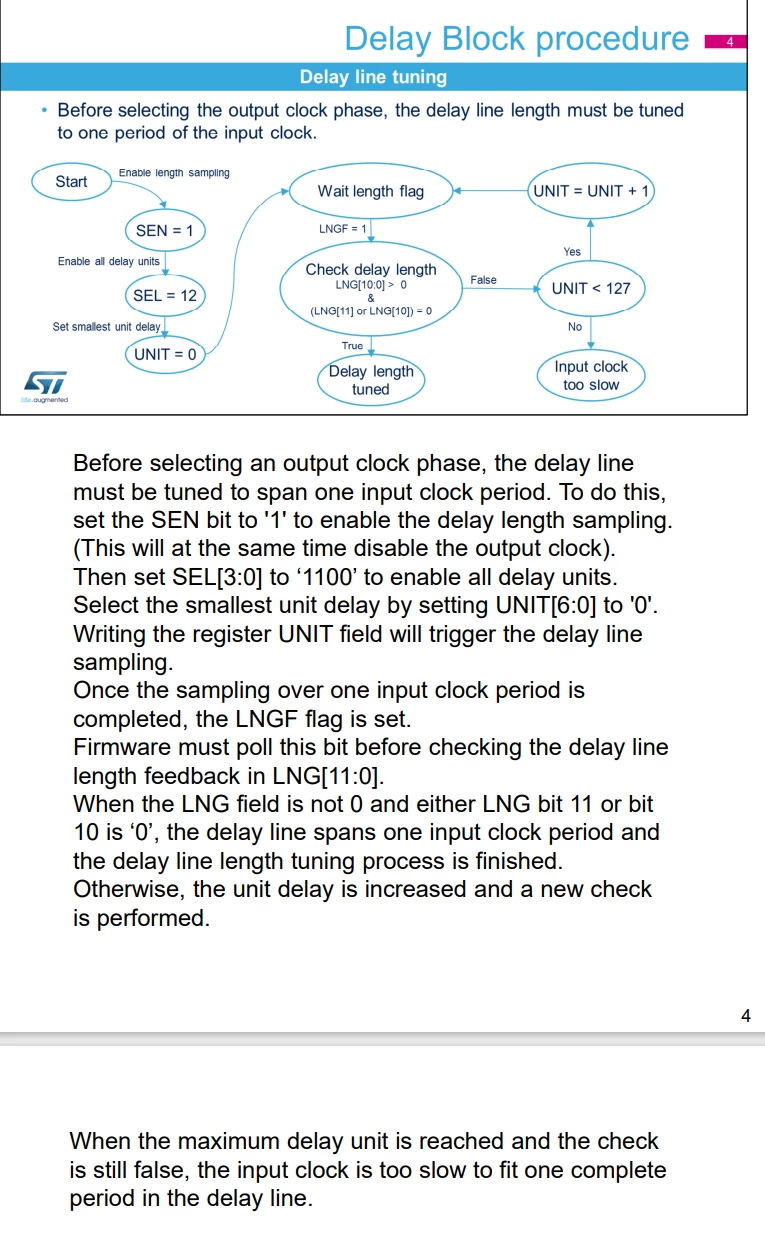

Please see this training for delay block procedure.
Note: The analog part of the delay block (the delay line) is PVT dependent, which requires the application to retune and recenter the output clock phase shifting if the STM32 VCORE voltage scaling or the environmental temperature change.

The delay block is an independent peripheral integrated inside the STM32 MCU that can be configured for the external serial memory controllers in order to fine tune the data-received sampling clock. Its role is also to apply a phase-shift to the clock or DQS signal when reading from external memory.
For more information about the delay block configuration, I advise you to take a look at AN5050 section 6 OCTOSPI and HSPI/XSPI interface calibration process.
Also you can find an example DLYB_OSPI_NOR_FastTuning has been tested with STMicroelectronics STM32U575I-EV (MB1550) board and can be easily tailored to any other supported device and development board.

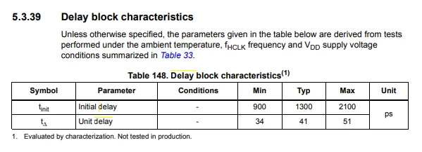

From the datasheet of STM32U5A9J-DK board, I have the following information:
  • Initial delay (tinit): Typical = 1300 ps (min = 900 ps, max = 2100 ps).
  • Unit delay: Typical = 41 ps (min = 34 ps, max = 51 ps).
Using the formula provided:
  • Unit delay = Initial delay + UNIT[6:0] × delay step.
  • Phase for output clock = Input clock + PhaseSel[3:0] × unit delay.
My calculation:
  1. Total delay needed: 2000 ps.
  2. Delay to achieve using UNITs = 2000 ps – Initial delay (1300 ps) = 700 ps.
  3. UNIT calculation: 700 ps ÷ 41 ps/unit ≈ 17.
Therefore, I have to set UNIT = 17
For fine-tuning, I plan to use PhaseSel for additional delay. Assuming the typical unit delay is 41 ps, setting PhaseSel = 1 or 2 could provide an additional 41-82 ps of delay if needed.

Thank you for sharing this calculation.
The parameters given in Table 148. Delay block characteristics are derived from tests performed under the ambient temperature, fHCLK frequency and VDD supply voltage conditions summarized in Table 33.
Also, it mentioned in the table three values min, typical and max.
I think, you can used this as initial values.
HAL_OSPI_DLYB_Cfg_Struct.Units = 17;
HAL_OSPI_DLYB_Cfg_Struct.PhaseSe = 1;
HAL_OSPI_DLYB_SetConfig(&hospi1, &HAL_OSPI_DLYB_Cfg_Struct);
