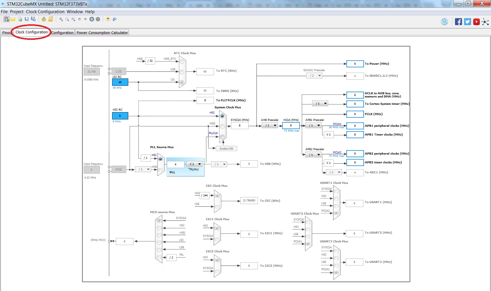

I am not able to find
STM32F37x_Clock_Configuration_VX.Y.Z.xls. I need it to configure the clock of STM32F373. Does anybody know where to find it?

Hi
mk912a
Iadvise you to use the
http://www.st.com/content/st_com/en/products/development-tools/software-development-tools/stm32-software-development-tools/stm32-configurators-and-code-generators/stm32cubemx.html
tool. It embeds
a clock-tree setting helper.
After generating your project (using your preferred tool chain), the ''main.c'' file will contain a function named ''SystemClock_Config'' where the system clock is configured.
