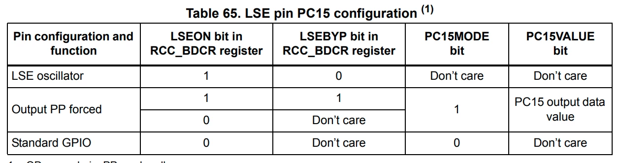

Configure STM32F072 PC15 as input port
I try to configure STM32F072 PC15 as input I/O using STM32F0xx Standard Peripherals Firmware Library, but not successful.
Ask for help.

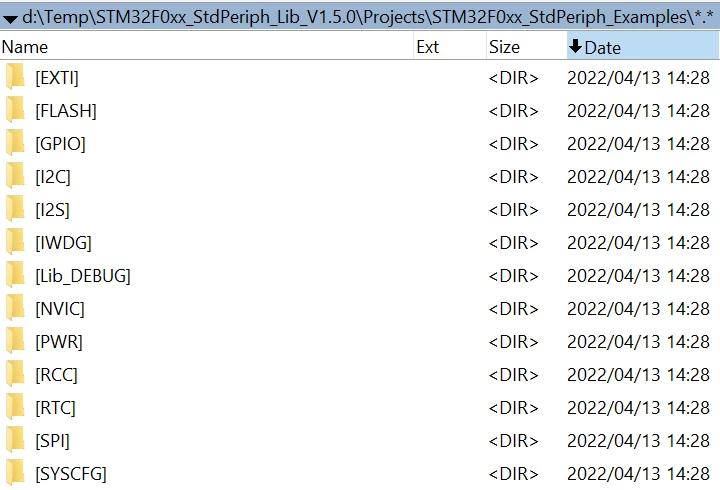

Peter BENSCH
Apr 13, 2022 11:44 AM UTC
Have you looked at the examples in the SPL?
How did you try to initialise the GPIO?

Apr 13, 2022 1:23 PM UTC
PC15 may have RTC/LSE functionality that needs disabled. Show your code.

Hi Peter and TDK,
Thank your reply.
Where is the examples in the SPL (SPI)? In STM32F0xx_StdPeriph_Lib_V1.5.0/../STM32F0xx_StdPeriph_Examples?
