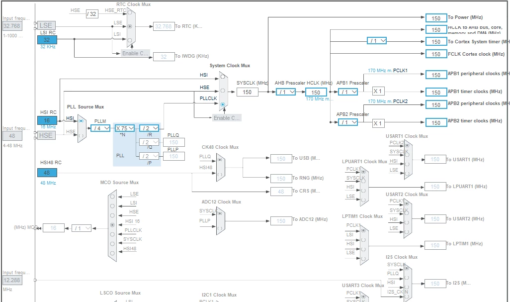

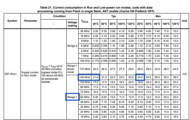

I have the NUCLEO-G431RB, and I am trying to measure the MCU current consumption in different operation modes and frequencies. I have connected a multimeter at JP6 (IDD) to monitor the current. The problem is when I set the frequency (f HCLK) as stated in the datasheet the readings I got are very different from the one in the datasheet. You can see in Figure 1 an example of what I did in configuring the clock trying to get similar values as in the datasheet in Figure 2.
Figure 1
the current value I got is 29mA.
I want to know exactly how I should configure the clock in a proper way to get the correct readings

Hello @Hussain
Are you sure all peripherals are disabled, prefetch is of, cashe is of, debug is disactivated.... Also, you need to make sure that temperture is exactly 25°.
Best Regards.

HussainAuthor
October 27, 2024
I did not activate any peripherals, also 'Cashe' ON and 'Prefetch' OFF as the datasheet states. I did set them both OFF and no changes happened.
Could you show me in detail how can I set the MCU settings correctly?
It is probably that I missed something that led to the wrong setup.
Andrew Neil
October 28, 2024
Are you sure that excludes all current to other things on the board - eg, the ST-Link?
Show the code you are using to perform this test - see the posting tips for instructions:
