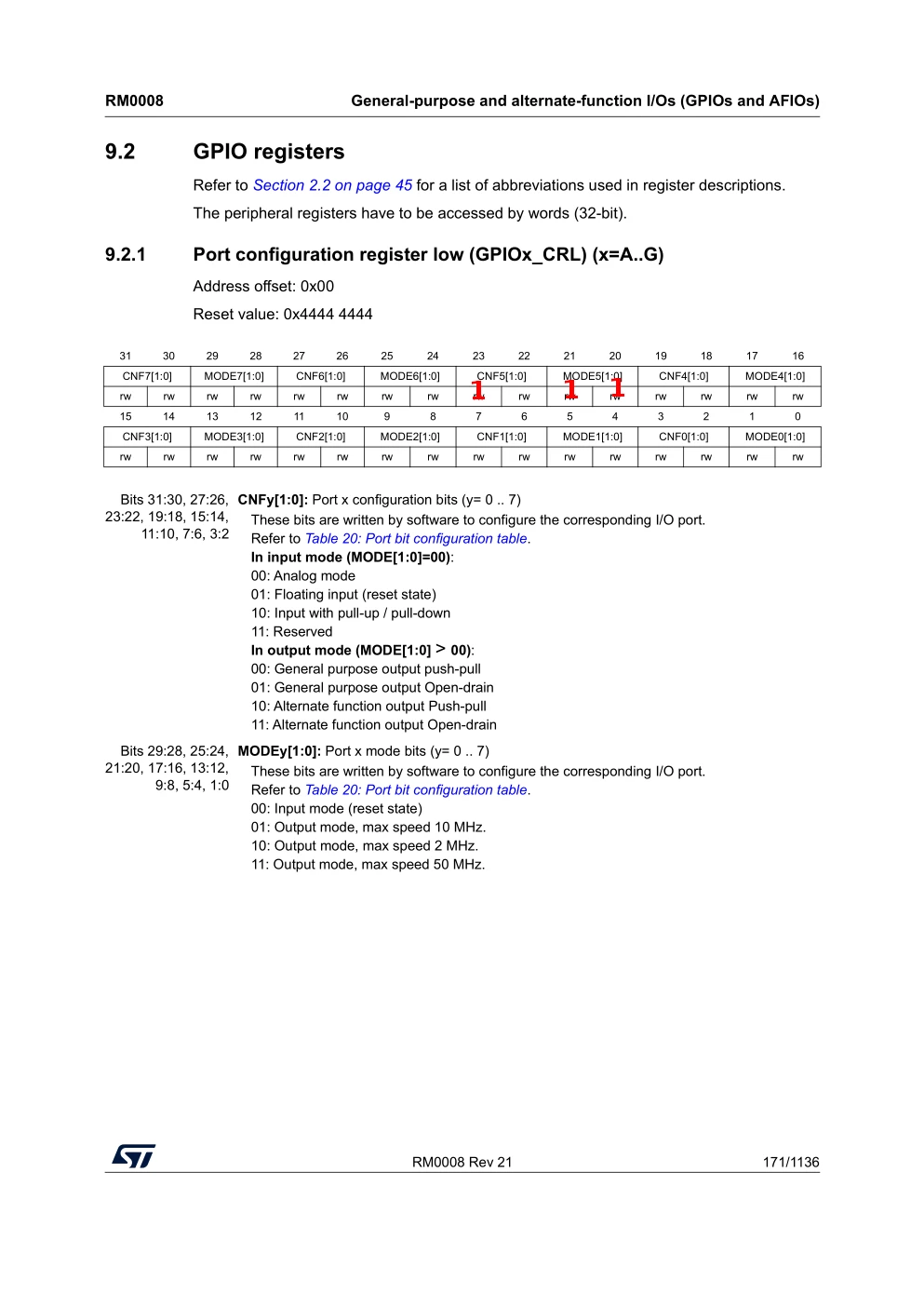

Hi, i came across a program to config alternation function for SPI GPIO port A.
GPIOA->CRL |= (11U<<20);       // PA5 SCK AF output push pull
GPIOA->CRL |= (11U<<28);       // PA7 MOSI AF output push pull
What does the 11U means? i know its something like setting the 20th bit to 11? is 11 the binary value for 3? how does the value 3 relates to PA5 SCK and 28 relates to PA7 MOSI ?  Anyone can advise?
Best answer by waclawek.jan
As others explained, 11U is decimal 11. Without the U suffix, it would be treated as signed, and shifting it so that the result is higher than 2^31-1 (the highest non-negative int32_t) is undefined by standard.
11 decimal is 1011 binary, so if GPIOA->CRL |= (11U<<20); sets the following bits:
other bits remain unaffected. MODE5 will be 0b11, so Output Mode, 50MHz; if the register was zeroed previously, CNF5 will be 0b10 i.e. Alternate Push Pull; if it was at its reset state, then CNF5 will be 0b11 i.e. Alternate Open-drain.
No, that is a decimal 11. Learn the C programming language:
https://en.cppreference.com/w/c/language/integer_constant
Reference manual documents all of the registers, bits and their values.

Hi JW,  thanks for the detailed explanation, i can rationalize with you till 50MHz.... but i dont understand the following :
"if the register was zeroed previously, CNF5 will be 0b10 i.e. Alternate Push Pull; if it was at its reset state, then CNF5 will be 0b11 i.e. Alternate Open-drain."
why is there 2 possibilities when the instruction 11 decimal --> 1011b, shouldnt CNF5 be only 0b10 ? where does the 0b11 at reset state come from? Pls advise...

thanks JW, could you kindly advise the datasheet number RM0.... couldnt see clearly, thx...
December 17, 2023
i  m reading RM0390 and i guess its not the right one....
waclawek.jan
December 17, 2023
Which STM32 do you use?
Only STM32F1xx have GPIOx_CRL registers.
December 18, 2023
STM32F446RE
waclawek.jan
December 18, 2023
Reset value, that is value after reset, of that register is 0x44444444; it means, CNF5=0b01, MODE5=0b00. If you OR that value with 0b1011, CNF5=0b01 OR 0b10 = 0b11; MODE5 = 0b11.
All this is relevant only for 'F1, i.e. irrelevant for 'F446; however, corollary remains, namely that you have to take into account the reset value of register when doing only ORs to set some of the bits.
