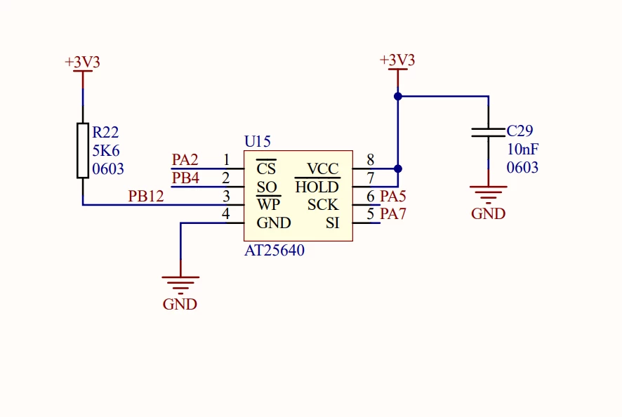

Hi amazing community... I have a legacy project developed with STM32System workbench..
I am trying to configure the spi to working with a eprom memory..
I cannot use the cube generator so I have to implement the init of the HAL by myself.
I made a test but it is not working..
Can you please tell me what is wrong?
Thanks a lot

HAL_GPIO_WritePin(GPIOE, GPIO_PIN_3 , GPIO_PIN_RESET);
/*Configure GPIO pins LED : */
GPIO_InitStruct.Pin = GPIO_PIN_3;
HAL_GPIO_Init(GPIOE, &GPIO_InitStruct);
/*Configure GPIO pins CS Chip select : */
GPIO_InitStruct.Pin = GPIO_PIN_2;
HAL_GPIO_Init(GPIOA, &GPIO_InitStruct);
static void GPIO_SP1_init(void)
// initialize CK alternate function push-pull
GPIO_InitStruct.Pin = GPIO_PIN_5;
GPIO_InitStruct.Speed = GPIO_SPEED_FREQ_HIGH;
// initialize SI alternate function push-pull
GPIO_InitStruct.Pin = GPIO_PIN_7;
// initialize S0 alternate function push-pull
GPIO_InitStruct.Pin = GPIO_PIN_4;
HAL_GPIO_Init(GPIOB, &GPIO_InitStruct);
static void MX_SPI1_Init(void)
/* USER CODE BEGIN SPI1_Init 0 */
/* USER CODE END SPI1_Init 0 */
/* USER CODE BEGIN SPI1_Init 1 */
/* USER CODE END SPI1_Init 1 */
/* SPI1 parameter configuration*/
hspi1.Instance = SPI1;
hspi1.Init.Mode = SPI_MODE_MASTER;
hspi1.Init.Direction = SPI_DIRECTION_2LINES;
hspi1.Init.DataSize = SPI_DATASIZE_8BIT;
hspi1.Init.CLKPolarity = SPI_POLARITY_LOW;
hspi1.Init.CLKPhase = SPI_PHASE_1EDGE;
hspi1.Init.NSS = SPI_NSS_HARD_OUTPUT;
hspi1.Init.BaudRatePrescaler = SPI_BAUDRATEPRESCALER_2;
hspi1.Init.FirstBit = SPI_FIRSTBIT_MSB;
hspi1.Init.TIMode = SPI_TIMODE_DISABLE;
hspi1.Init.CRCCalculation = SPI_CRCCALCULATION_DISABLE;
hspi1.Init.CRCPolynomial = 10;
if (HAL_SPI_Init(&hspi1) != HAL_OK)
//Error_Handler();
/* USER CODE BEGIN SPI1_Init 2 */
/* USER CODE END SPI1_Init 2 */
