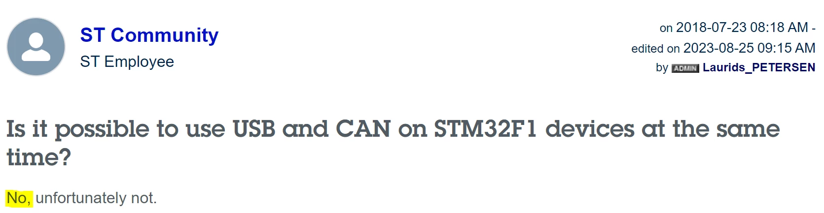

Hello @ssunlove
The link you're mentioning: Concurrent use of USB and CAN with STM32F103
Unfortunately no, the USB and CAN can be used in the same application but not at the same time on all the STM32F1 series, including the STM32F105R8T6.

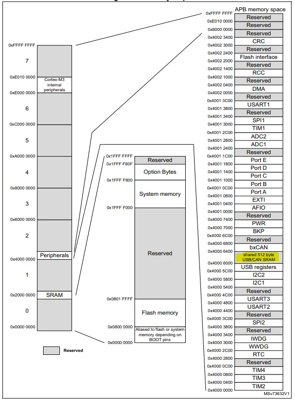

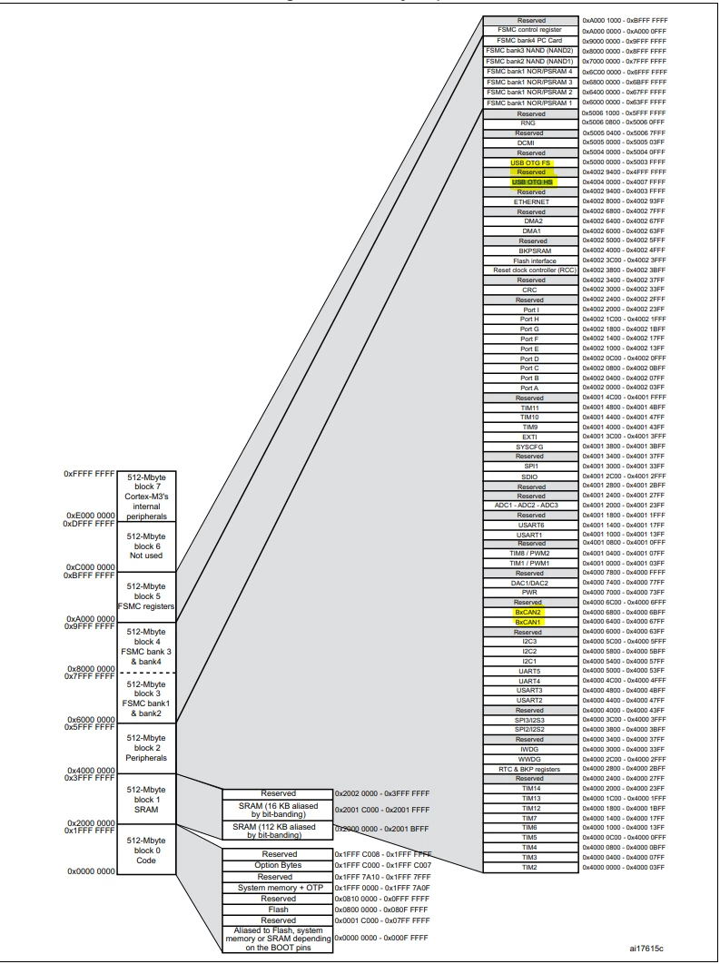

ssunloveAuthor
November 29, 2023
Then is STM32F2 possible?
November 29, 2023
Yes, you can check this information by looking at the memory mapping in your product datasheet
For STM32F1 series: There is a shared 512-byte SRAM between USB and CAN
For STM32F2 series: it has separate USB and CAN peripherals
