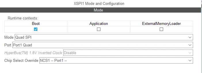

For example if you configure the XSPI1 mode Quad SPI (no multiplexed mode), then generate the code.
 You can see the XSPIM configuration in the generated code
 sXspiManagerCfg.nCSOverride = HAL_XSPI_CSSEL_OVR_NCS1;
 sXspiManagerCfg.IOPort = HAL_XSPIM_IOPORT_1;
 if (HAL_XSPIM_Config(&hxspi1, &sXspiManagerCfg, HAL_XSPI_TIMEOUT_DEFAULT_VALUE) != HAL_OK)
 Error_Handler();
But, if you asked about XSPIM peripheral clock, you need to set XSPIM clock when using the XSPI interface.
 __HAL_RCC_XSPIM_CLK_ENABLE();
 __HAL_RCC_XSPI1_CLK_ENABLE();

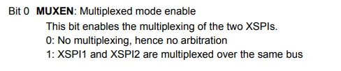

The MUXEN bit is used to enable multiplexed mode.

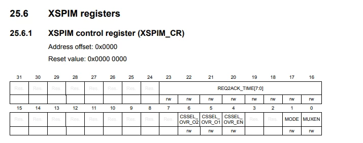

I think there is no EN bit in XSPIM_CR:
Yes, the XSPI interface can be configured as Quad-SPI for 4-line data transmission.
 You are absolutely right, there is no such register; I was negligent and meant the MUXEN.
I think what I mean to ask is: The XSPIM has to be enabled (clock on AHB5) for the XSPI signals to be available?
