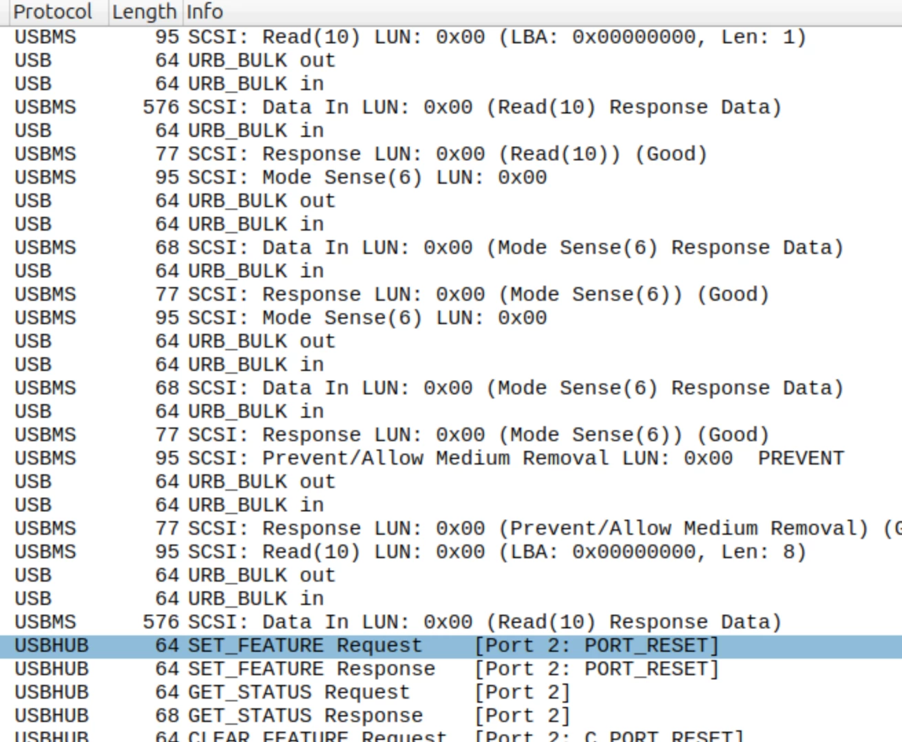

I'm working on a firmware which currently run in USB vendor interface (bInterfaceClass = 0xFF) and it's working.
Now I want to add MassStorage. My Firmware is a bit older so I add all usb composite parte by my self (in usbd_core ...) . I defined USE_USBD_COMPOSITE and set :
#define USBD_CMPSIT_ACTIVATE_MSC 1
#define USBD_CMPSIT_ACTIVATE_CUSTOMHID 1
#define USBD_MAX_CLASS_INTERFACES 2U
#define USBD_MAX_SUPPORTED_CLASS 2U
#define USBD_MAX_CLASS_ENDPOINTS 2U
(I use custom HID class for the Vendor interface and I edited USBD_CMPSIT_CUSTOMHIDDesc )
I set Msc first 'cause I read that some OS
prefer.

But when I run I feel like the first interface start (Msc) and then stop responding when the second try to start and when nothing works.
Does anyone have any idea what I'm doing wrong?

I have some logs if it's can help :

I look communication with Wireshark and it's like firmware stop responding et communication restart. I don't understand why.

MA4AuthorBest answer
Senior
Sep 5, 2025 2:34 PM UTC
On Wireshark we can see that host (PC) ask to read Len:8 that means 8*512 =4 096 and the firmware answer with a 576 data packet. So host reset the usb because he doesn't like the answer.
My issue was a SD read issue not USB.
