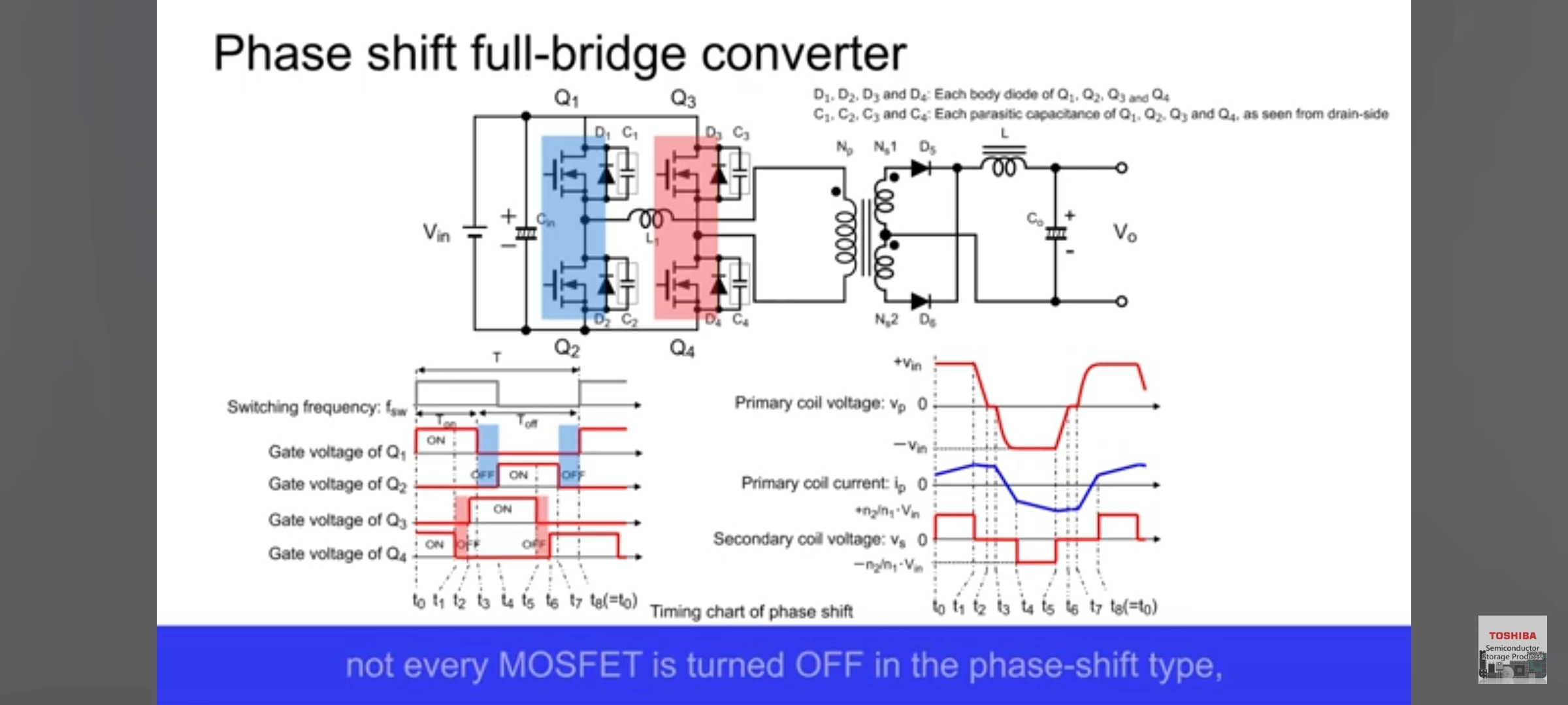

the same intervalthe same intervalthere is lag between themthere is lag between themHi ,I use stm32f401rct6 board ,I need to generate two pairs of complemdntary pwm signal to drive 4 igbt for dc full bridge converter in soft switching way,
How can achieve two pairs by some leg between them as shown in picture?

When set TIM1 CH1 and CH2 to generate two pair of complementary signal there is no lag between them, but I need to make lag as shown in picure

You need/want two complimentary signals with delay between them ,
so need :
- two timers with can have deadtime (maybe F303)
- a very complex "advanced" timer , that can generate "combined mode" with complimentary channels

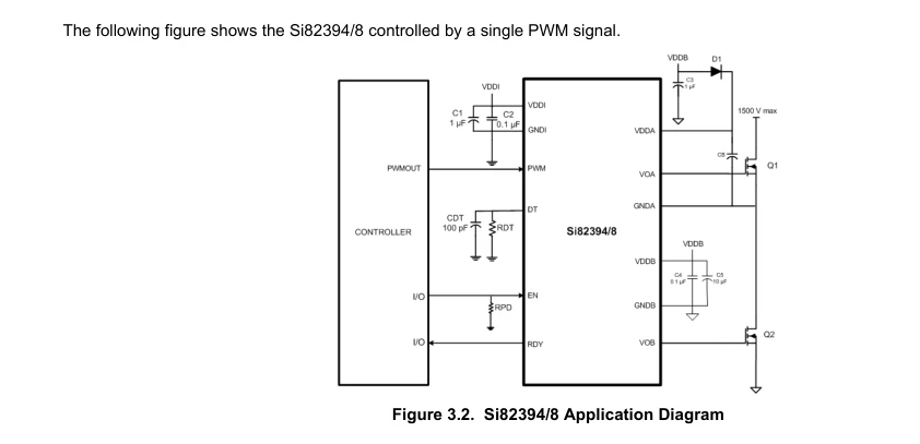

- use your actual F401 and its timers to just make two 50:50 pwm signals, that can have phase shift from 0...100% between the output signals, and do the complimentary signal and deadtime with a gate driver, that have built in deadtime. (I used Si82394 for this, or IRS2008 ; or just look at mouser , there are many drivers to choose:
