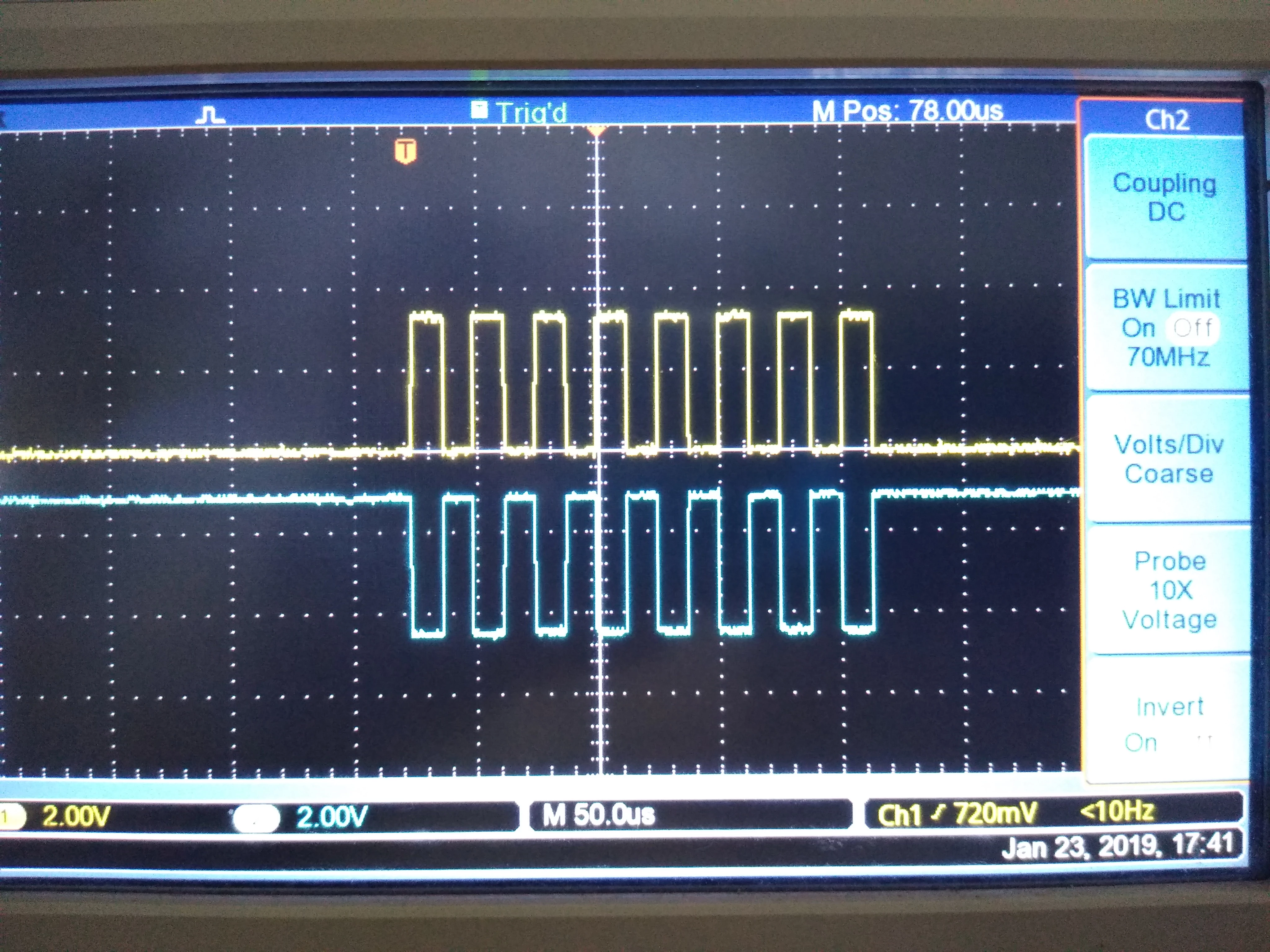

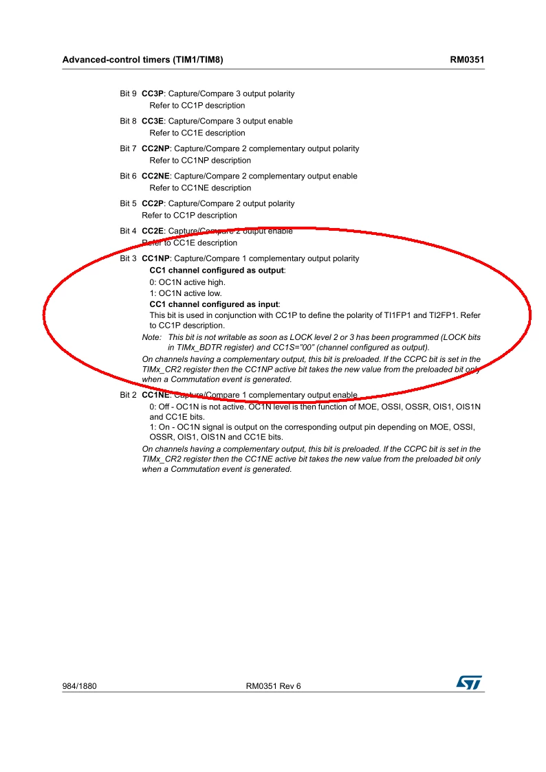

I have generated complementary PWM signal on STM32L496ZGtx. I used TIM1CH1 and TIM1CH1N. I am using one pulse mode so that every 1 second, I generate complementary signal. However one channel starts at active HIGH and another starts at active LOW. How should I start and end both the channels at active low? See attached image.
