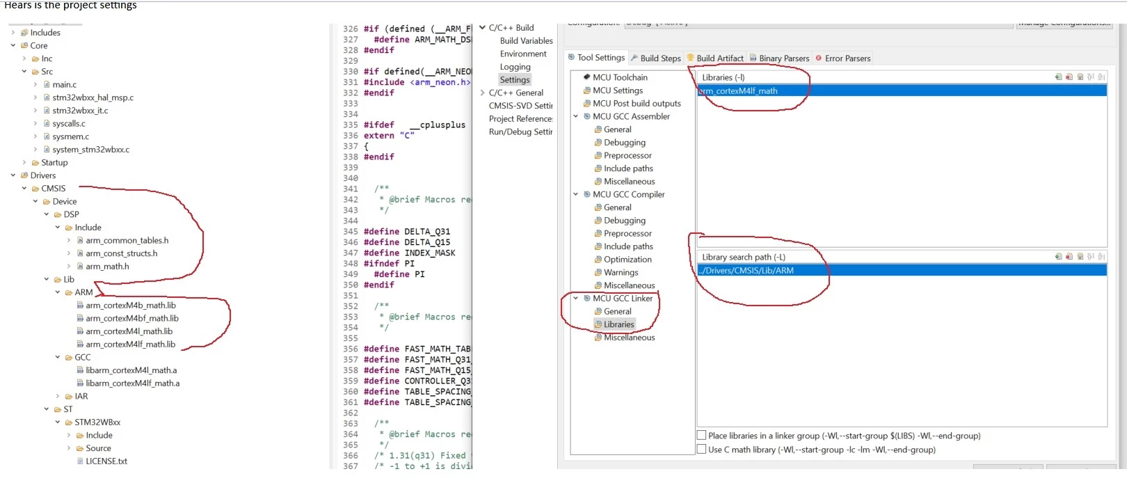

The linker is saying cannot find -larm_cortexM4lf_math.
Hears is the project settings
0693W00000Y80MdQAJ.jpgI followed
I am stuck, so hoping you can help...
Best answer by KnarfB
You didn't. In that article, DSP folder is a sibling to Device, in your porject, it is a child folder.
Also avoid using relaive paths, use the provided macros.
hth
KnarfB
hth
KnarfB

Thank you fixed it.
