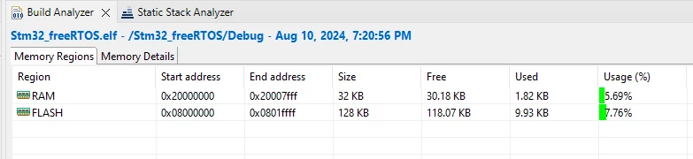

Compile error: `.bss' will not fit in region `RAM' when adding FreeRTOS tasks
Hello everyone,
I am using NUCLEO-F410RB Board embedding STM32F410RBTx Device and I was trying to port the FreeRTOS bare minimum(kernel w/o CMSIS) api here and it is throwing me an error when I create a bare minimum task(no global variables or arrays in the main either.)
Note: It is building properly when I am not using the FreeRTOS Apis.
The Linker file .ld says that the chip has this much Memory

Any thoughts on what is missing over here?

Use the Build Analyzer -> Memory Details tab to find what is using all the space.

This is the Build analyzer w/o calling FreeRTOS tasks, but when I add tasks in to main.c, the code is not even compiling, so I am unable to analyze how much space is occupied.
@TDK Can we use Build analyzer with out actual elf or executable?
August 11, 2024
I think you need an ELF to analyze.
Edit the linker file to increase the size of the ram, then compile it, then see what's taking up so much space.

32 KB is too little for the RTOS. Maybe just to try how it works at all or something very simple. Get at least 128K.
(consider the interrupt stack and the application data & buffers ...)
