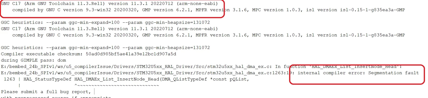

I am getting internal compiler error: Segmentation fault when optimization is set to O2 or O3. I am using GNU C17 (Arm GNU Toolchain 11.3.Rel1) version 11.3.1 20220712 toolchain.
I am compiling code for STM32U575ZI MCU. Compilation goes through without error when optimization is set to O0 or O1. As soon as Optimization is set to O2 and above, I see the compiler error: internal segmentation fault. Below is screenshot of error. Also attached is compilation log.
Can someone tell the reason for internal Segmentation fault and help to fix it?

Hello @SauravShandilya
To reproduce the issue, I used the DMA_LinkedList example of the STM32U5CubeFW:
(~\STM32Cube_FW_U5_V1.4.0\Projects\NUCLEO-U575ZI-Q\Examples\DMA\DMA_LinkedList)
I'm using  C/C++ ARM GNU Toolchain version 11.3.0.202307110141, I tried all the optimization options and it is working on my side. By comparing the compilation flags versus the one you shared shared, I see that you enabled both '-D' 'USE_FULL_LL_DRIVER' '-D' 'USE_HAL_DRIVER'
  • Can you check with only keeping '-D' 'USE_FULL_LL_DRIVER'
  • Can you also add the following option to compilation:   -std=gnu11

Hi @CMYL ,
Thank you for sharing a response.
I removed -DUSE_HAL_DRIVER and added -std=gnu11 in compilation flag. However, that did not resolve the issue on my side.
I can notice the difference in Toolchain version. You are using 11.3.0 whereas I am using 11.3.Rel1. As per Arm GNU Toolchain Downloads – Arm Developer 11.3.0 can not be download and I am using 11.3.Rel1 in production code which is difficult to change.
Can you check with same Toolchain which I am using, which is 11.3.Rel1. Below is link of toolchain:

@SauravShandilya @CMYL Was there any resolution to this issue? I am having the same problem occur when using STM32CubeCLT 1.15.1 when building in Release. I see that my compiler version is also 11.3.1.Rel1. I'd like to get this resolved so that I can continue using STM32CubeCLT with the VS Code extension, and not have to move to an externally managed compiler version.
