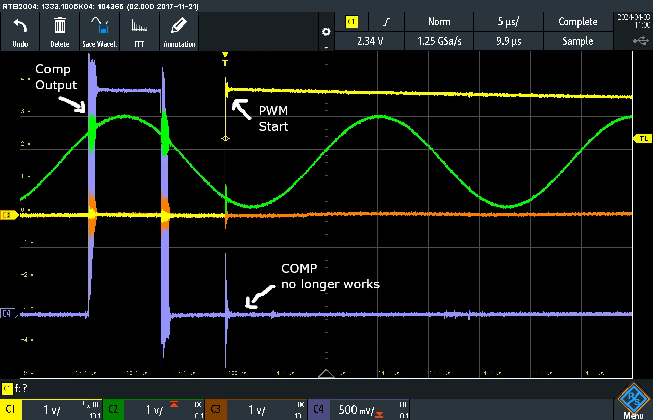

Apr 3, 2024 9:15 AM UTC
I add an osciloscope image to better explain the text above

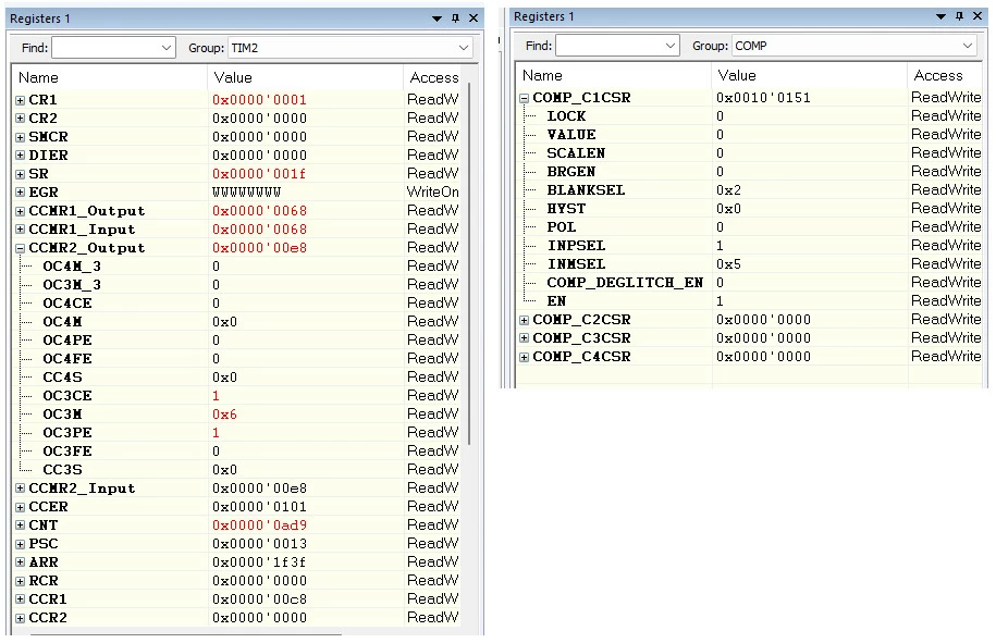

Apr 4, 2024 8:57 AM UTC
I also attach the TIMER and COMP register, they seem to be configured well:
I'm starting to suspect a bug in the hardware design of the STM32G431 ?
