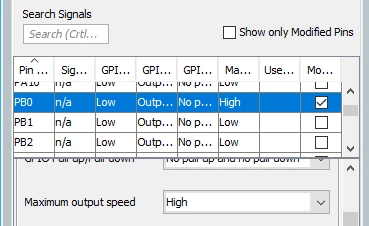

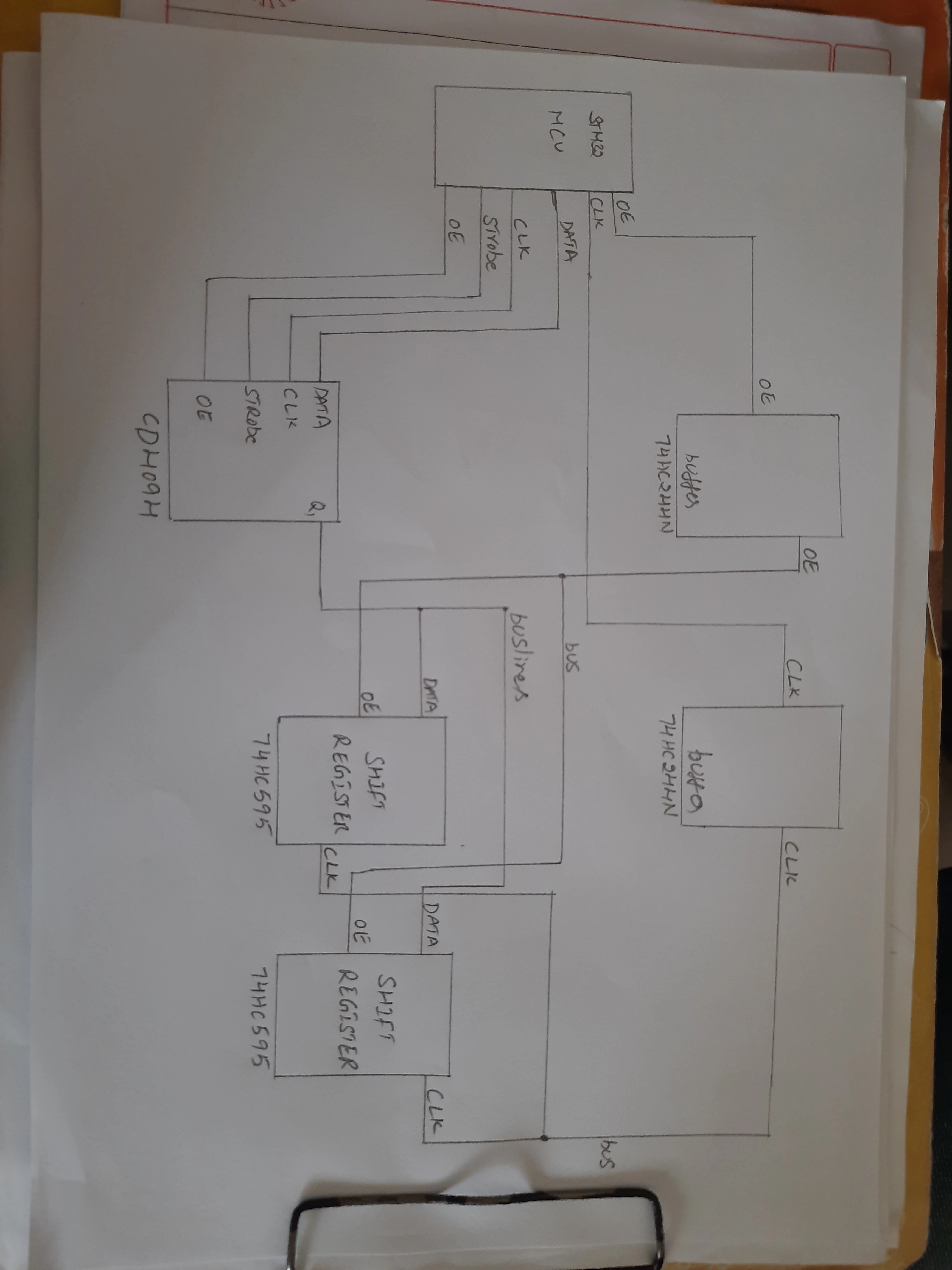

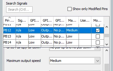

Hi Experts,
PFA the hardware design. I am trying to send data to parallel (not cascade) 74hc595 over common bus lines from CD4094B. I am sending 16 bits to place first 8 bits in 74hc595(1) and second bits in 74hc595(2). But I am getting same 8 bits (10101010) on both 74hc595 devices.
Could you please let me know how to send 16 bits such that first 8 bits should place in first 74hc595 and second 8 bits should place in second 74hc595. Please find the code snippet below and let me know if I am missing anything.
