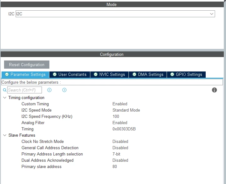

I am trying to communicate with i2c DMA without interrupt. My MCU is STM32G474RET6.
I've read that it is possible but can't find how to do it.
How can i communicate in slave mode with i2c dma?
Since my interrupts disabled, can't use the callback functions. I've checked the signal and after address, bus is hanged and not gave ACK.

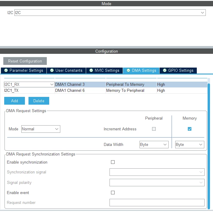

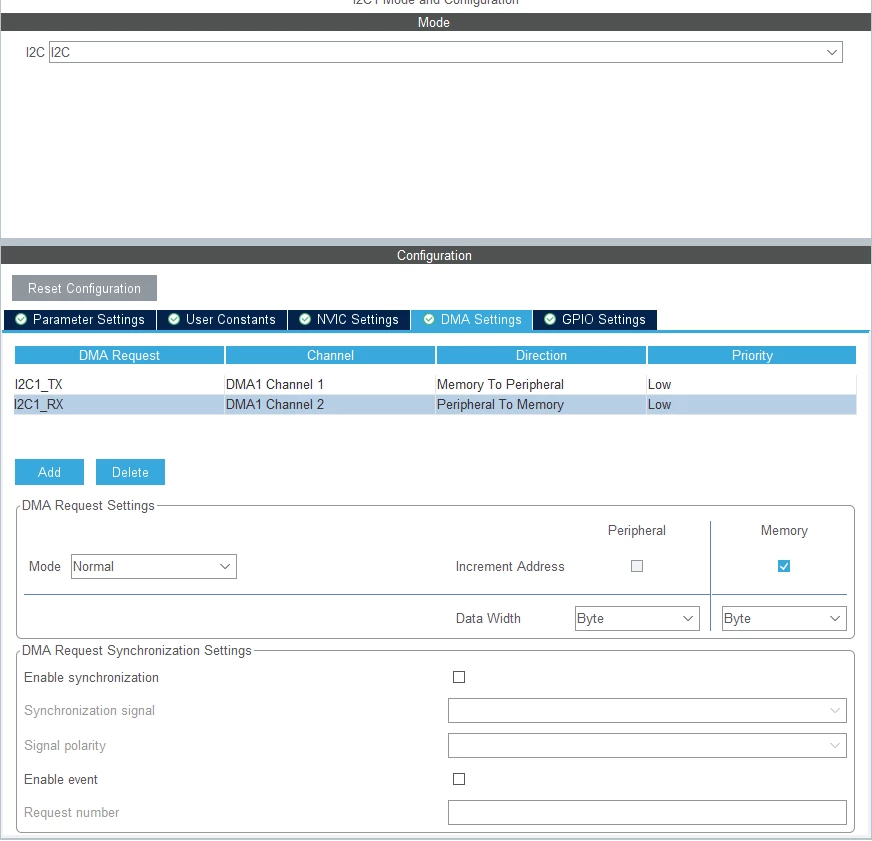

Hello @Günce Yasan​ ,
For I2C communication using DMA, you should configure DMA setting using STM32CubeMX by adding I2Cx_TX or I2Cx_RX as showing in the figure :
Foued

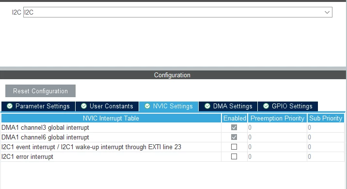

May 23, 2023 2:07 PM UTC
Hi @KHALSI_Foued​
Yes i did those configurations. Here's my cubemx conf.
_legacyfs_online_stmicro_images_0693W00000bkgOZQAY.pngNormally when interrupt enabled, i use callback functions to do my receive/transmit proccess. Since i don't use interrupt, i see in my function I2C ADDR flag is set, and after that i try to receive with dma but my program goes into infinite loop. Is there some function i should call before receive func. or etc. ?
