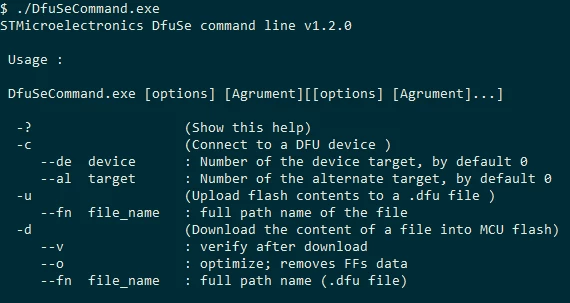

    David SIORPAES
    David SIORPAESBest answer
    Mar 21, 2018 10:02 AM UTC
    Posted on March 21, 2018 at 11:02
    You can use DfuSe command line version as follows:
    DfuSeCommand.exe -c -d --fn image.dfu
    All options are:

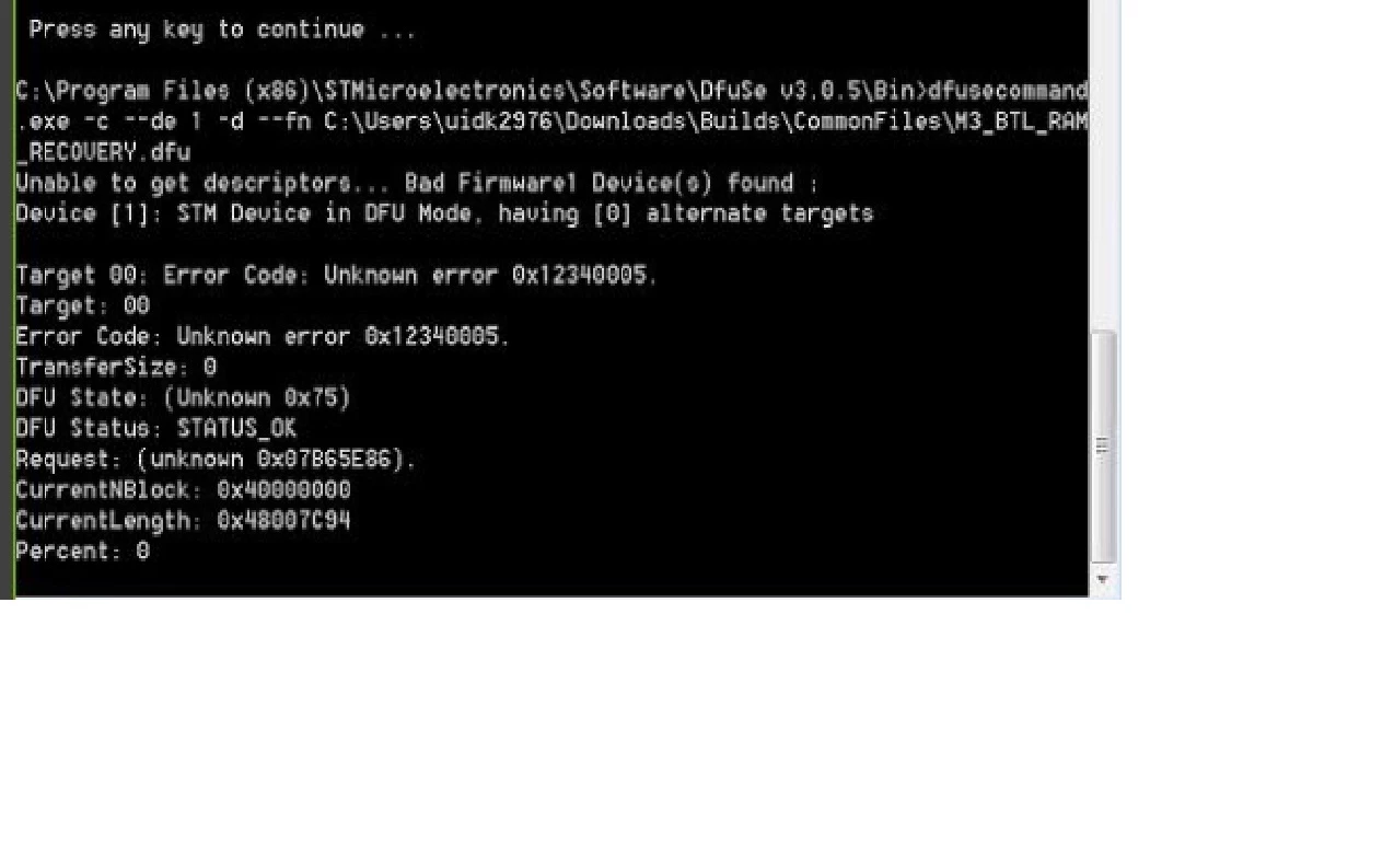

    Harsha kadlaskar
    Mar 21, 2018 10:19 AM UTC
    Posted on March 21, 2018 at 11:19
    Hi David,
    Thank you for quick reply..
    But i have already tried with commands which are generating errors like below:

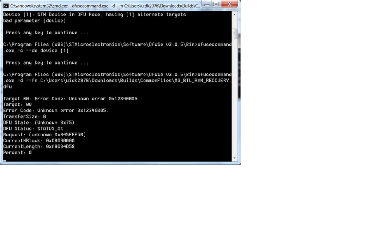

    Harsha kadlaskar
    Mar 21, 2018 11:31 AM UTC
    Posted on March 21, 2018 at 11:31
    Harsha kadlaskar
    Mar 21, 2018 11:32 AM UTC
    Posted on March 21, 2018 at 11:32
    where should the image.dfu file should be stored ,because i have save it in another directory D:\ and calling from there.
    Its popping like File does not exist.
