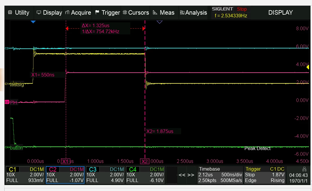

i am trying to figure out, why this interrupt is delayed that much.
The com trigger comes from timer 1, which works as expected. Also the delay here is as expected too (apart from a 50ns deviation). There is a delay of 1.3us, from the time i can observe, that the com trigger has successfully triggered a loading of the registers in timer 8, to the time i can observe, that the com interrupt of timer8 has been fired.

If i understood correctly, then you generate rising edge at yellow trace in TIM1_CC_IRQHandler() and falling edge at TIM8_TRG_COM_IRQHandler() yes ? Then you have to check how much time takes TIM1_CC_IRQHandler(). Because if you did not set higher IRQ priority for IM8_TRG_COM_IRQ, then MCU have to finish TIM1_CC_IRQHandler before begin of TIM8_TRG_COM_IRQHandler(). What is your IRQ priority schema ?

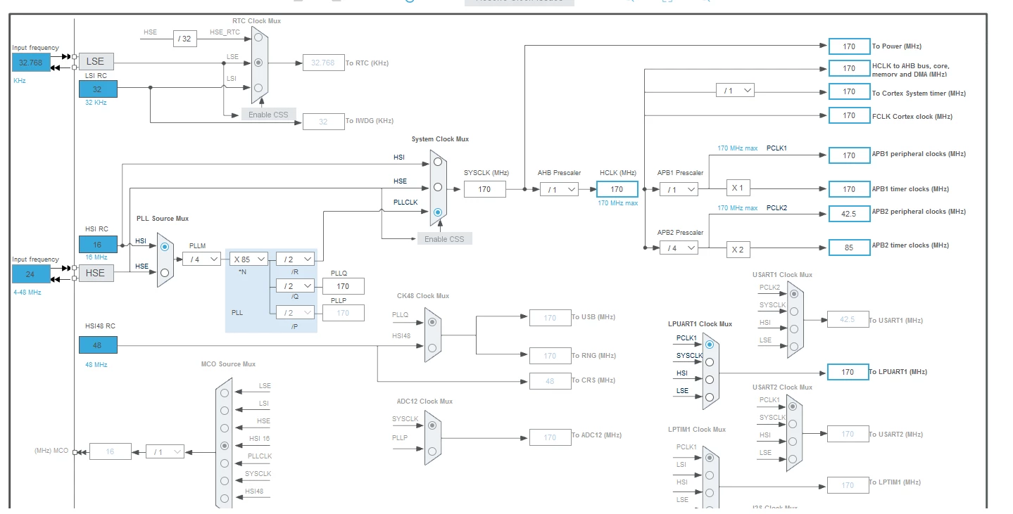

MCU type ? SysClock frequency ? Optimization level ?

Its a G431RBT6 It runs at 170Mhz.
Opt level is debug
How exactly do you observed that?
What do we see on that scope screenshot?

On the screenshot you can see:
Green line: capture input of tim 1
Yellow line (rising edge): set in capture interrupt of tim 1
Red line: compare output of tim 8
Yellow line (falling edge):  set in com interrupt of tim 8
cursors X1 and X2, that should be close together in my understanding.

I am not 100% sure, but pretty close to it. It is the preloaded value from an interrupt (tim 1) before. Then the com update happens while in the next interrupt.
That edge of the red curve really got me confused here.
