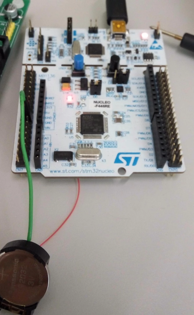

On a Nucleo board, is it as simple as pulling the 0 ohm resistor off SB45, and connecting a coin cell [something like a CR1220] to pin33 [VBAT] and ground, in order to have battery backup for the RTC registers?

    Sure!
    I've done it many times on my F4 Nucleo boards.
    Here my VBAT is Pin1!
