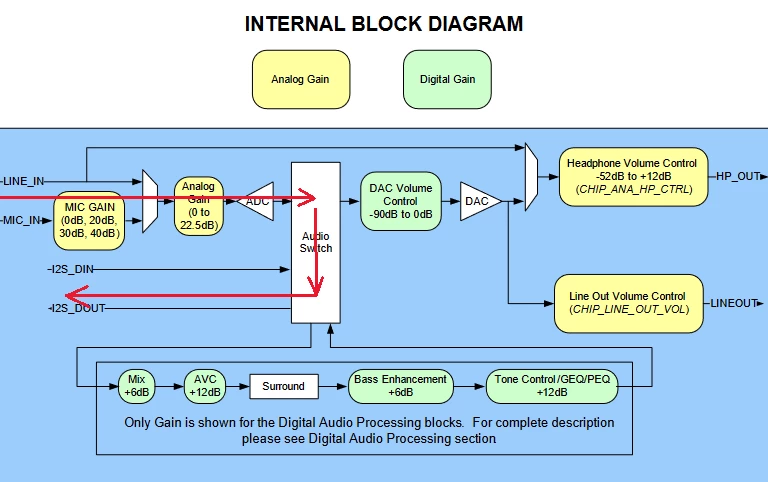

I would like to know how to retrieve the acquisition values ​​: INPUT -> ADC -> SAI -> µP like the diagram below :
I have a program that works for this : DMA -> SAI -> DAC But this is not the way I would have wanted to make my CODEC work. Do you have any idea how should i proceed ? Thanks in advance

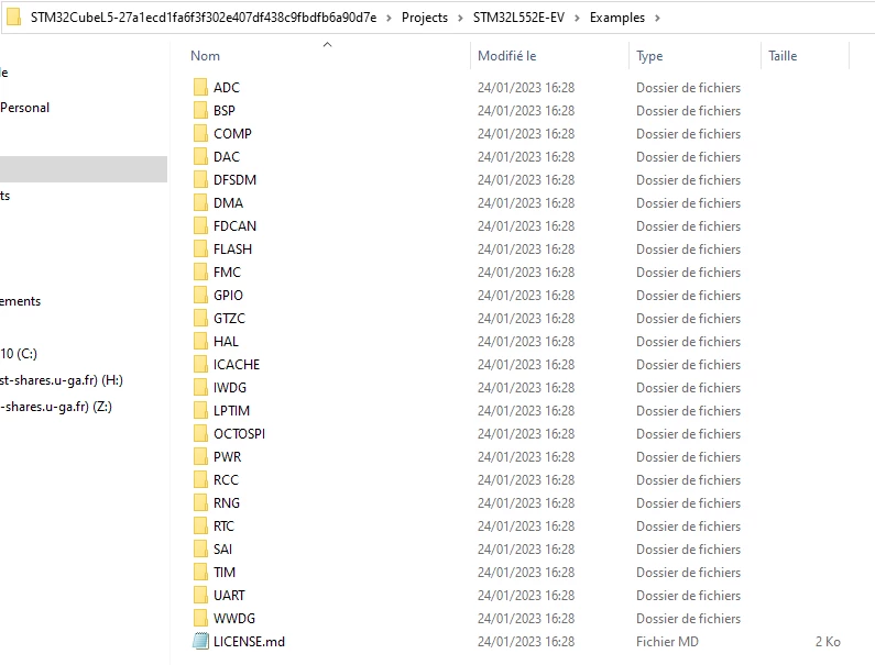

DYann.1
DYann.1Author
Senior II
August 24, 2023
Hi jiangfan,
Thank you for this link but where is what is the code where it uses the CODEC to retrieve the values ​​via an ADC ? I've explored all examples of this CODEC with this card and haven't seen a single place where one can retrieve the data via an ADC.

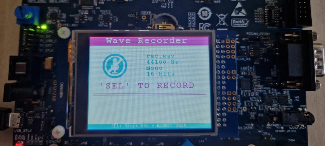

Thank you for this information but after me, It's easier to have the .ioc configuration file than the opposite. Now after downloading the demo project on my card I have this screen and do you know how to proceed for the registration ?
I have this information below, but how to register ? It probably saves on the SD card on the evaluation board ?
jiangfan
August 30, 2023
I agree with you that it is better to have the .ioc configuration file. but you cannot imagine to see .ioc configuration file for each project of STM32 cube FW package, like the case of STM32L552E-EV/Demonstration.
sorry, I don't understand what you mean "how to proceed for the registration".
STM32L552E-EV/Demonstration readme.txt clearly mentions:
- An audio recorder sub-module provides a complete audio record solution and delivers a high-quality
record experience. It supports record in WAV format at 44.1khz sample rate in mono. The recorded file
rec.wav is saved on the SD card (it is overwritten at each new record).
which means you have to plug a SD card into the SD card slot before you start a recording.

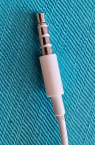

After trying with the headphones provided in the kit, it does not work either.
I don't know if I need to put a jumper somewhere on the board for this to work ?
jiangfan
September 2, 2023
The later one, white headphone, should be the CTIA type headphone with microphone - as I remember, white join between points is CTIA type headphone.
I suppose the white headphone provided in the kit should support the board demonstration. You may plug it to your mobile phone to check if it can record voice.
about jumper setting, you may refer to readme file already shared at github.

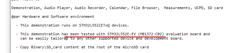

DYann.1
DYann.1Author
Senior II
September 2, 2023
@jiangfan wrote: You may plug it to your mobile phone to check if it can record voice.
Now phones no longer have a headphone jack, only with bluetooth. And about the readme file there is nothing special :
In principle this should work but it doesn't. Where is the error ?
