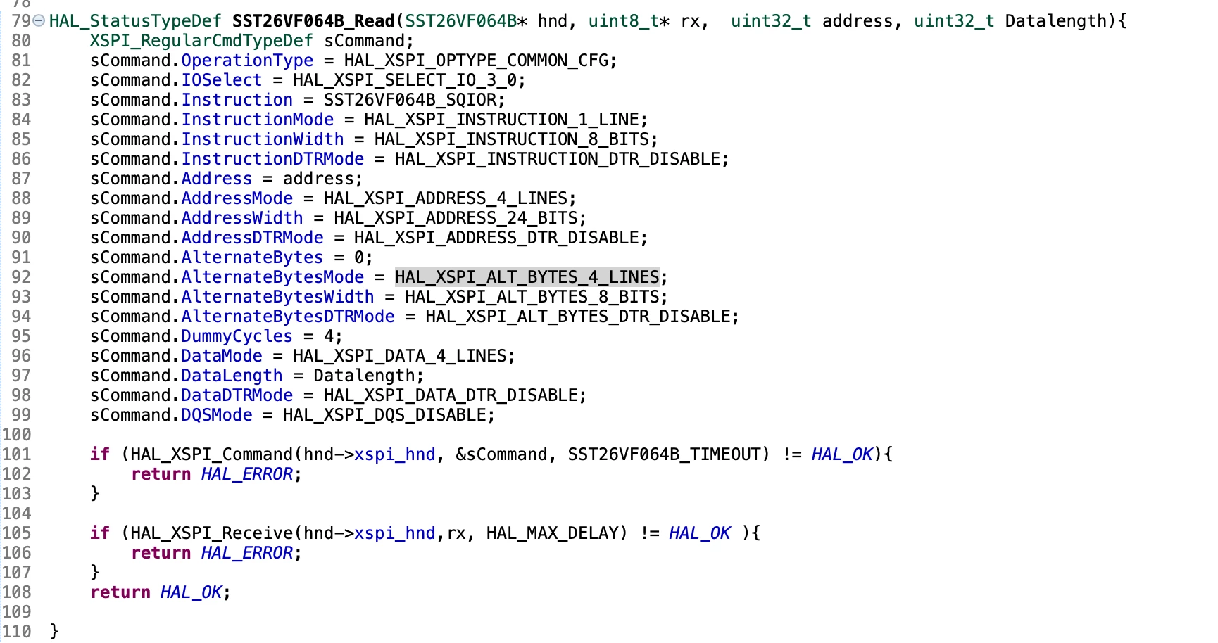

I am currently trying to write to an external Flash via QSPI (SST26VF064B). So far I have been able to successfully configure the chip as required and I have also been able to read some configuration registers in the flash so I know I can communicate the chip. However, when I try to write or read the memory, my code gets stuck in the function XSPI_WaitFlagStateUntilTimeout and the transfer error flag in the XSPI_SR is set. The reference manual says this flag is set if an invalid address is accessed in indirect mode but I am writing to the address 0x010000 which is a valid address. How can I fix this issue?
Here is a screenshot of my read function
Best answer by Kwame
I was able to get it to work. It turns out that the size of the device specified was 64 bits so any address outside the range causes a transfer error.

Hello @Kwame ,
Could you please give more detail about the issue:
Which STM32H7 are using? Are using STM32H7S?
Is the issue encountering for memory mapped mode or indirect mode?
Could you please take a look at the errata sheet .
May be XSPI example can help you.
Thank you.

KwameAuthor
August 23, 2024
Thanks for your response. I am trying to use my own drivers with the external loader project on the STM32H7R7. Is there any documentation for this? The only thing i can find is this https://wiki.st.com/stm32mcu/wiki/Getting_started_with_External_memory_Manager_and_External_memory_loader which uses the NOR SFDP driver.

KwameAuthorBest answer
August 23, 2024
