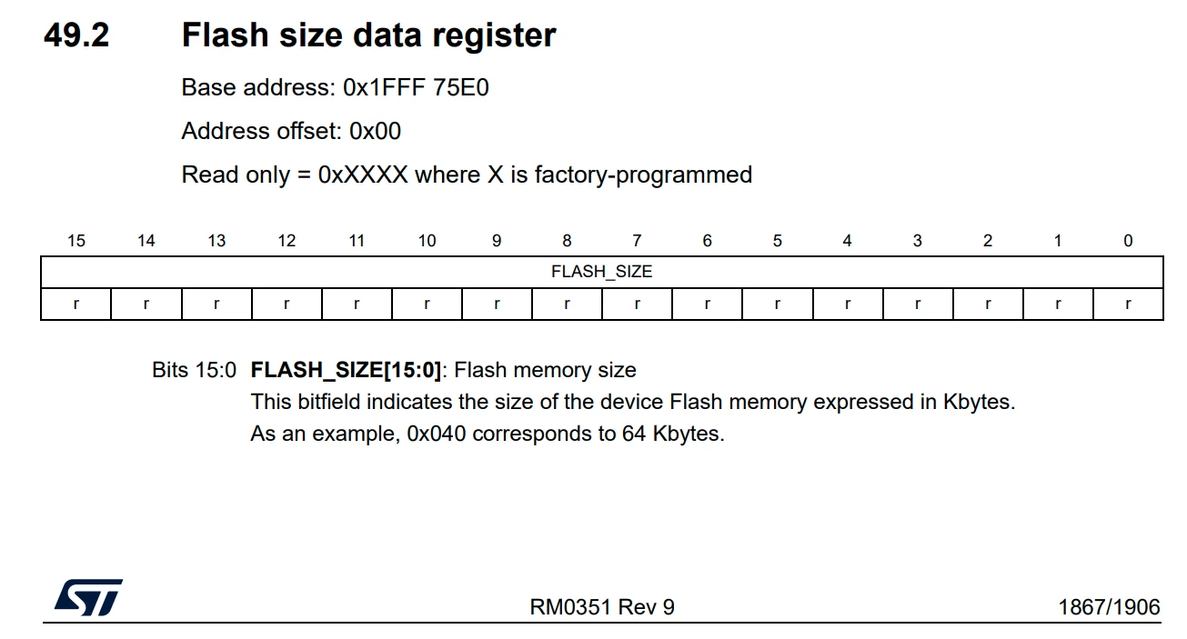

Say, I have a STM32L431RB (128k,64k) on a board design.
This is the lowest flash size on the 6 chips on the STM32L4x1Rx 64pin variety.
It certainty looks like I can drop-in any of the larger flash/ram chips as the pin outs all look the same.
But do I need to actually rebuild the binary for each variant?
For example the STM32L431RC is exactly the same, but with more flash, while the 451 and 471 variants seem. Can it take the binary for for a STM32L431RB.
Has anyone tried this?
I ask this mostly to see if I can be a bit better protected against supply chain shortages in the future.
One tricky area for me might be in-field upgrades and tracking of which variants are going into which boards.
TDKBest answer
March 7, 2022
You don't need to change the firmware if it fits in the smaller flash size. The same exact code will run on both chips just fine. No changes necessary.
You can read the FLASH_SIZE register to determine how much flash is onboard.

Firmware should be able to determine part (die) and tested flash size.
Some parts use the same die. I use L432RB, same die used for L432RC, both have 256KB physically.
You'd perhaps look at the startup.s files and diff them, this is where model level differences and incompatibilities would be most apparent.

>>Are you saying that it's possible for a single firmware binary to adapt its behavior based on an underlying check of the MCU?
Sure, I've built firmware for a range of F4 parts, that check the chip type, set clocks and PLLs based on max speed (84, 100, 168, 180 MHz, etc), and size of heap from available RAM on specific devices. Then use dynamic allocation at start-up rather then large static allocations.
One could create a vector table on-the-fly, or have multiple firmwares sharing common code sections/blocks
