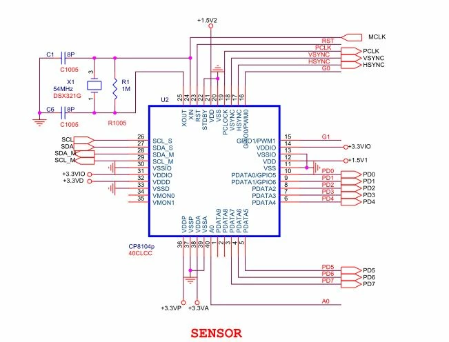

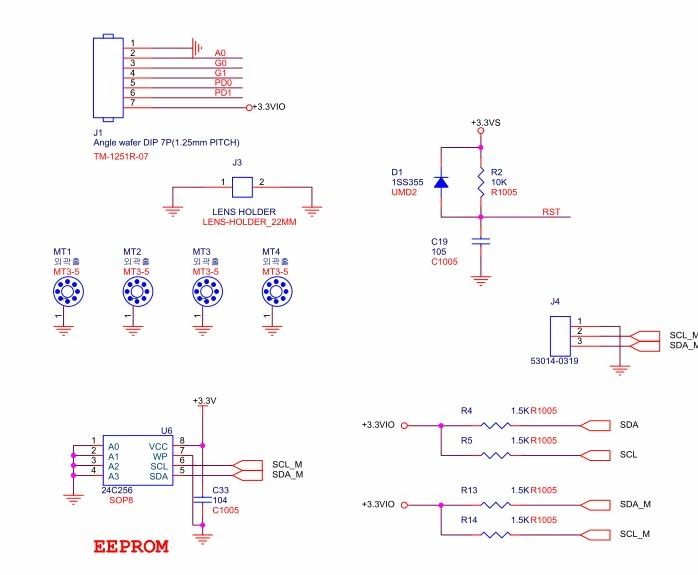

That's the sensor module and the related connections. I need to know whether the schematic shows a pin outlet for the PD[0:7] and the rest of the pins required for DCMIThis is another portion of the schematic:
The confusion I have now is that i see that PD0 and PD1 have outputs but the rest don't seem to have an output to be connected to the external processor. Could you please just clarify this?Much appreciated!

I need some help understanding a schematic of a cmos image sensor module we are going to purchase due time. The issue is that we have been testing out with a 8bit DCMI using a stm32f429 for previous modules but this doesn't seem to have the outlets for the data pins.
