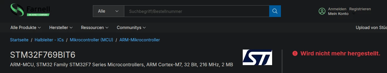

Closest replacement for STM32F769BIT6
Dear Sir/Mdm,
Could you please advice the closest replacement for STM32F769BIT6. Since this is EOL. Thanks.

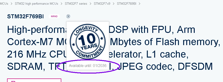

You can check in Cube the compatible chips…
I would take the STM32H743BI , as best compatible chip.
And some pins, as VCAP, you have to check and change on new board version.
See DS of H743 and check yourself.

The closest exact drop-in replacement for the STM32F769BIT6 is the STM32F779BIT6, which shares the identical Cortex-M7 core and LQFP-208 footprint.
Replacement Part Core & Speed Flash / Package Key Differences vs. STM32F769BIT6
STM32F779BIT6 Cortex-M7 @ 216MHz 2MB / LQFP-208 Identical specifications, but adds a hardware cryptographic hash processor. This is the most seamless drop-in replacement.
STM32H743BIT6 Cortex-M7 @ 480MHz 2MB / LQFP-208 The recommended long-term migration path. Significant performance upgrade. Shares the exact physical footprint, though engineering will need to validate power domains (VCAP) and clock trees.
STM32H753BIT6 Cortex-M7 @ 480MHz 2MB / LQFP-208 Shares the same footprint and performance upgrade as the H743, but includes additional cryptography hardware.
STM32F767BIT6 Cortex-M7 @ 216MHz 2MB / LQFP-208 Pin-compatible, but lacks the MIPI-DSI host and hardware JPEG codec. Only viable if the end application does not utilize these advanced display features.
Cross-Reference & Migration Details
While the STM32H7 series (H743/H753) shares the exact mechanical LQFP-208 footprint and is designed for pin-to-pin compatibility with the F7 series, it is not a blind swap. Firmware adjustments are necessary to accommodate the 480MHz clock speed, different RAM architecture, and updated peripheral registers. If a client requires immediate, unmodified board functionality to fulfill a BOM shortage without triggering an engineering redesign, the STM32F779BIT6 is the safest sourcing recommendation.
