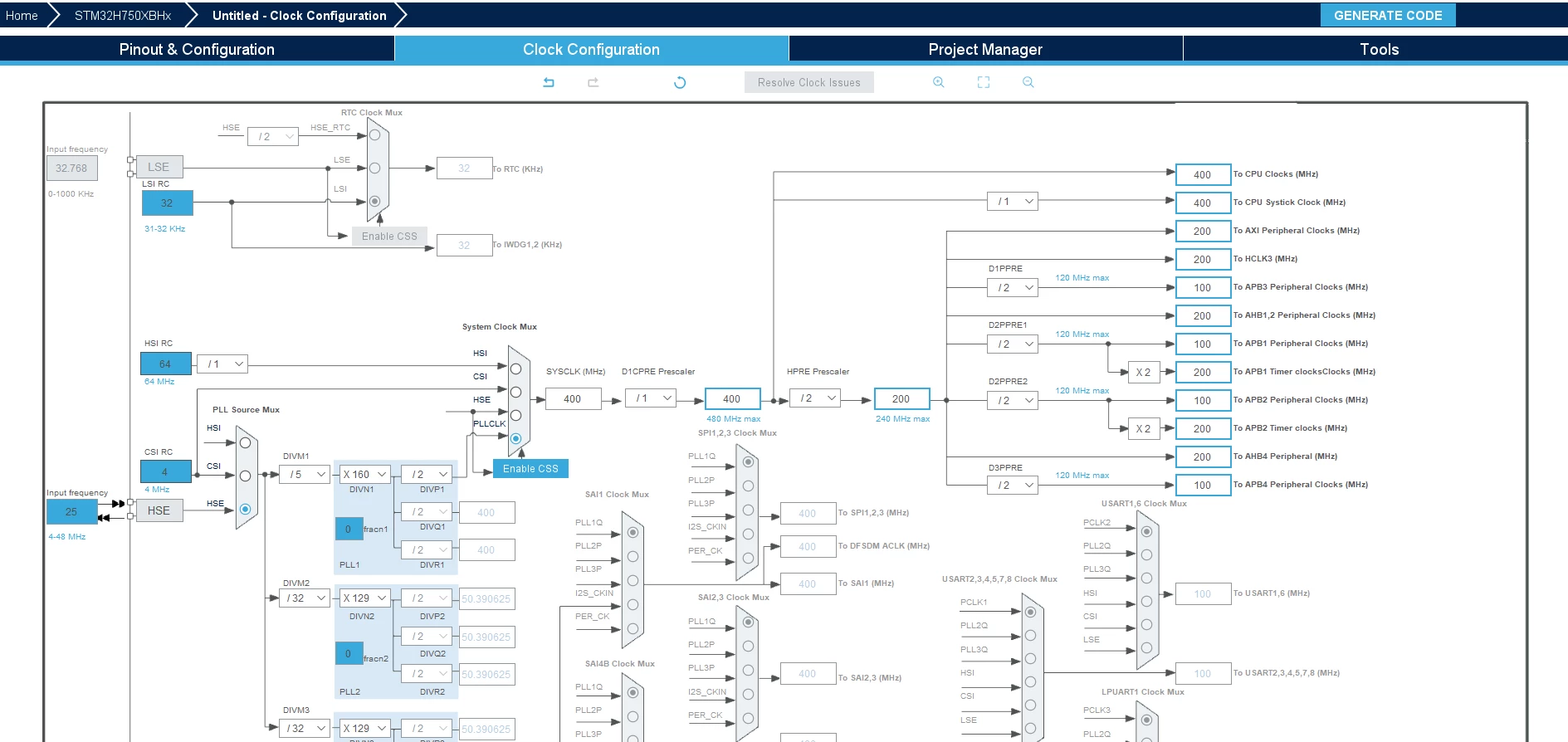

Foued_KH
January 10, 2023
Hello @pk84​ ,
I advice you try with STM32CubeMX to set Timing via Clock Configuration. It's more easier for you to manage your clock tree.
For your example :
  • Enable the HSE as: Crystal/Ceramic Resonator.
  • Choose the external HSE clock and switch to PLL internally.
  • Set your desired frequency.
RCC_OscInitStruct.PLL.PLLM = 5;
RCC_OscInitStruct.PLL.PLLN = 160;
Foued

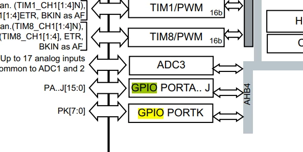

Foued_KH
January 13, 2023
Hello @pk84​ ,
The GPIOC and GPIOF are mapped on the same bus and no problems with the STM32H750 Disco
0693W00000Y8CRpQAN.pngTry to verify your PCB .
Foued
