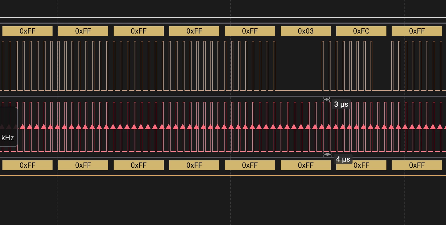

Attached :
- Screenshot of the logic analyzer
As you can see I do not have 3us but 3.042 and this is not always the case

Use logic analyzer or oscilloscope with much higher sampling frequency then your MCU frequency or you will not be able to distinguish measurment relics from real MCU output jitter. Imagine that you generating perfect square wave with frequency 72MHz/20=7.2MHz (period 277.8ns). If  you sample this signal by analyzer with 24MHz (period 41.67ns) the you will see jittering output of 2 consecutive periods in duration 6*41.67 (250ns) and one period in duration 7*41.67 (292ns) - on perfect square wave ! And that can leads you to wrong conclusion that jitter comes from MCU output ...

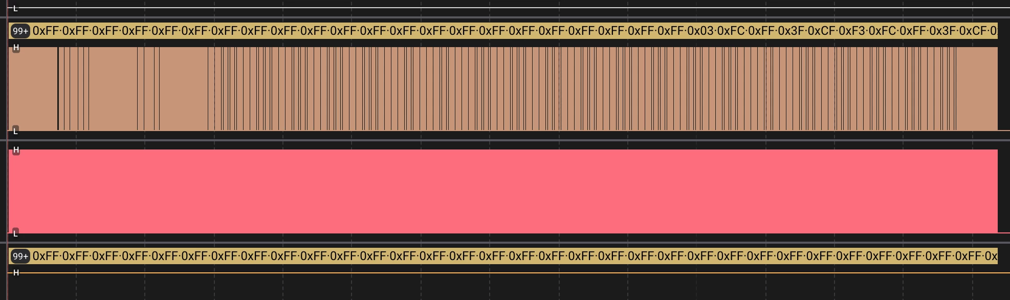

In the end this is the output on the logic Analyser:
What is left todo:
- Manage disk head movement based on GPIO interrupt (and then move to the right SD card Sector and cluster)
- Doing some testing to see if the timing is accurate enough.
I will keep you posted on how I progress.
Vincent
