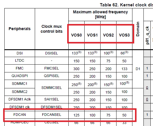

good morning. I want to implement a can loopback on my STM32H755, but when I enable FCAN1, then my clock can't resolve it issues and shows this for FDCAN in the picture below. how could I resolve this problem?

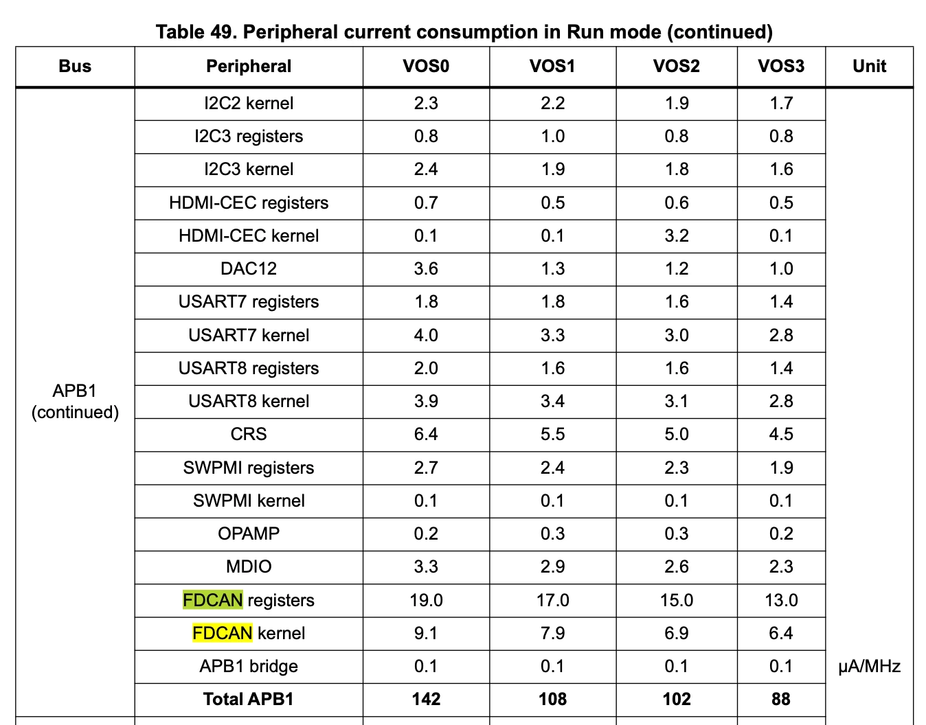

Capture d’écran 2024-09-13 à 13.48.09.pngthan you very much for the quick response
those are the values I found. I do not know how to understand the values and adjustate the timer.
No these are the values for the power consumption.

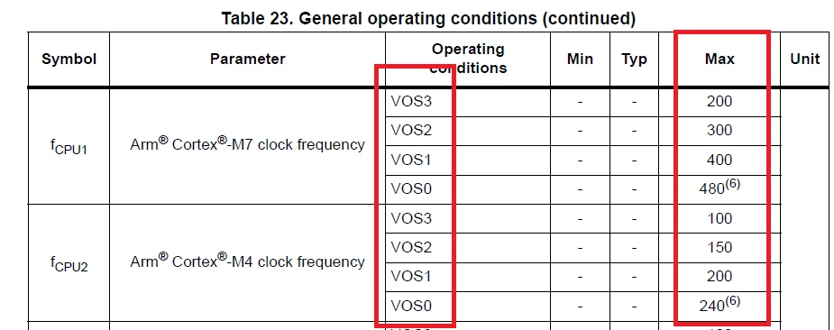

You need to set the voltage scale according to the system frequency, from DS12919 Rev 2:
Based on that voltage scale (VOS) level, you can know what is the maximum allowed kernel clock frequency you can set for FDCAN:

You need to check the reference manual and check your system frequency as well as what voltage scale (VOS) configuration you set:
Could you please share your ioc file?
