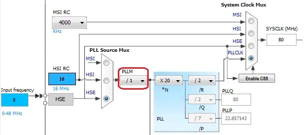

I am working on a project with stm32l432kb. It uses 8 MHz external clock in order to achieve 80 MHz system clock. I've configured clock with the Cube. The diagram shows system clock at 80 MHz, nevertheless the real clock seems to be about 16 MHz. Reading clock with  HAL_RCC_GetHCLKFreq() gives value of 15875000. I've verified that the defined HSE_VALUE is 8 MHz. Here is the Cube generated code for clock configuration:

    In one of non up to date SM32CubeMX revisions there was an issue with correct code generation for STM32L4 clock configuration. The issue was that PLLM parameter was set to different value than indicated by STM32CubeMX and as a result system clock frequency was not correct (lower than expected). For example STM32CubeMX was indicating PLLM  = 1, while the generated code was using something else.
    Here in your code I don't see PLLM parameter, so maybe this could be a root cause. Could you please try to add PLLM parameter between those two lines of code?:
    RCC_OscInitStruct.PLL.PLLSource = RCC_PLLSOURCE_HSE;
    RCC_OscInitStruct.PLL.PLLN = 40;
    I guess that in your case PLLM is equal to 1, so it would look like this:

    As it was also mentioned in another post (Szymon Panecki), the PLLM assignment was missing. Assigning it to 1 solved the problem.

    Yes, PLLM assignment was missing, and I haven't paid attention.
    Inserting
    RCC_OscInitStruct.PLL.PLLM = 1;
    solved the problem.
    My fault - I needed to verify the registers
    Thanks a lot to everyone for taking time to help me with this issue.

    The issue on CubeMx 4.25 about
    PLLM assignment missing passed along to our CubeMx team for fix in the next release.

    Hi Palitsky,
    This will be fixed next release, as a workaround you can use the RCC LL driver where the PLLM is well configured
