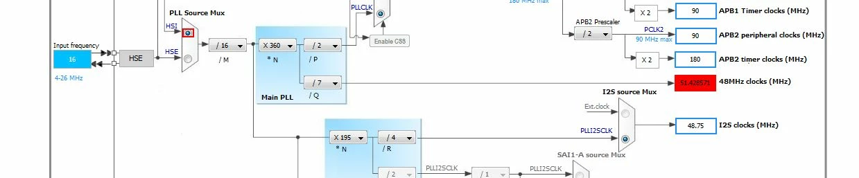

i am designing a board based on f329. The problem is, i have a red mark on the clock configuration on HSI(16MHZ) and also 48MHZ clocks. when i am configuration with HSI(16MHZ). Could anyone tell me why ?i have attached the screnshot.
Could you please give us the right STM32 part number that you use, so we can help you?You can set the clock value you need as target and CubeMX will do needed claculation for other parameters (M, N, P, Q).-Syrine-
and mainly the section ''Clock tree configuration view''. It describes how to use CubeMX for clock configuration.CubeMX allows you to set a target frequency and it calculates other parameters based on this target and clock source.-Mayla-
