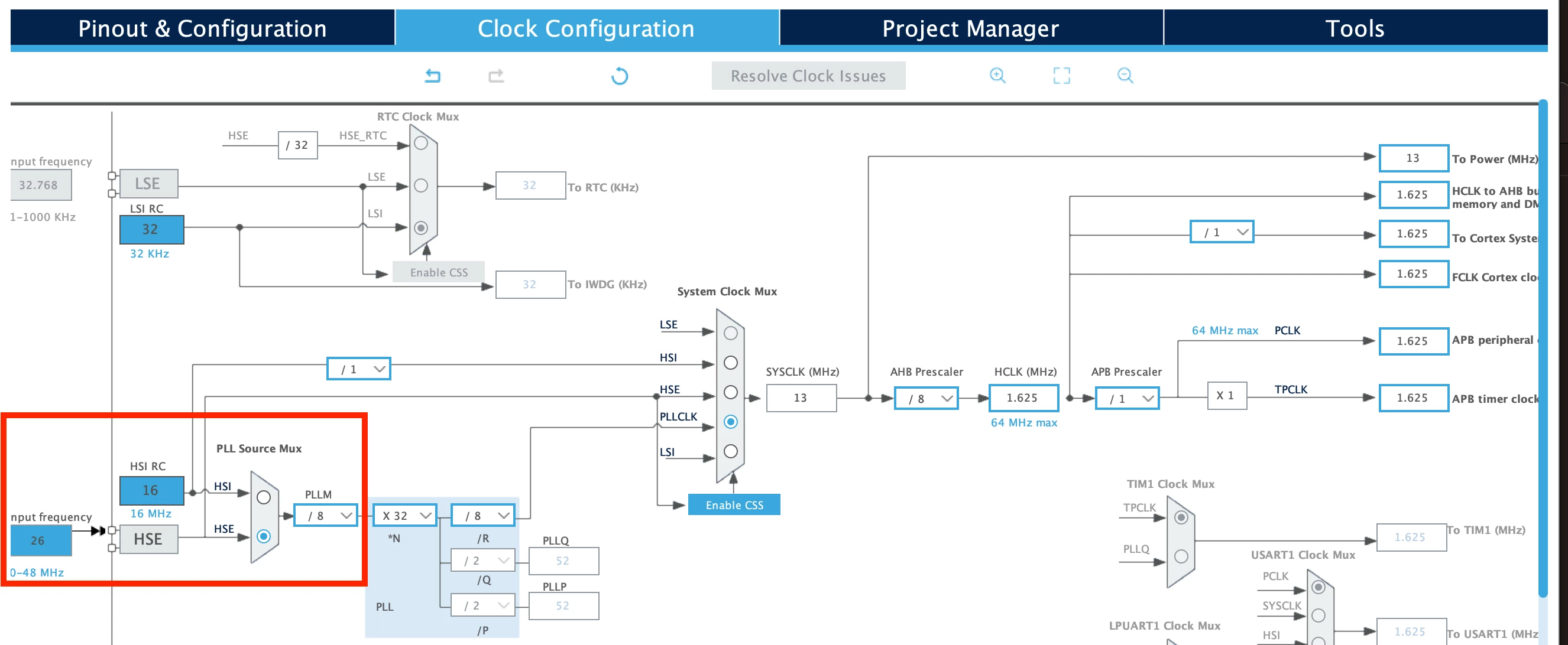

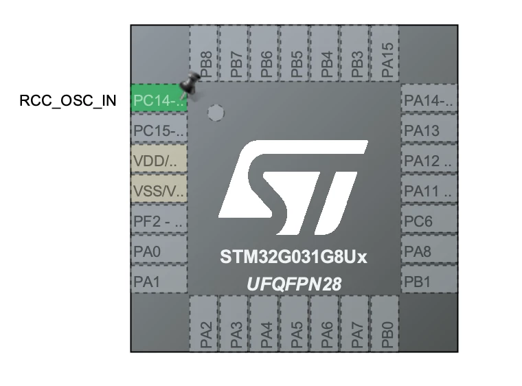

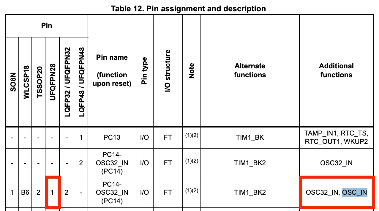

I'm confused by your statement that PC14 cannot be used as an HSE input.  The STM32G031x4/x6/x8 data sheet (DS12992 Rev 4) and STM32CubeIDE (1.17.0) both indicate that PC14 can be configured as OSC_IN for the UFQFPN28 package, feeding the HSE block.  See attached screenshots.  Are you saying this is wrong?
As I understand the documentation, PC14 is supported as a CMOS HSE clock input in bypass mode.  If that's true, can you address the original question?

After double-checking, the STM32G031G8U6 in a UFQFPN28 package does support HSE in bypass mode.
Refer to DS12992 Rev 4, "5.3.7 External clock source characteristics". PC14 can be used as input for HSE in bypass mode.
