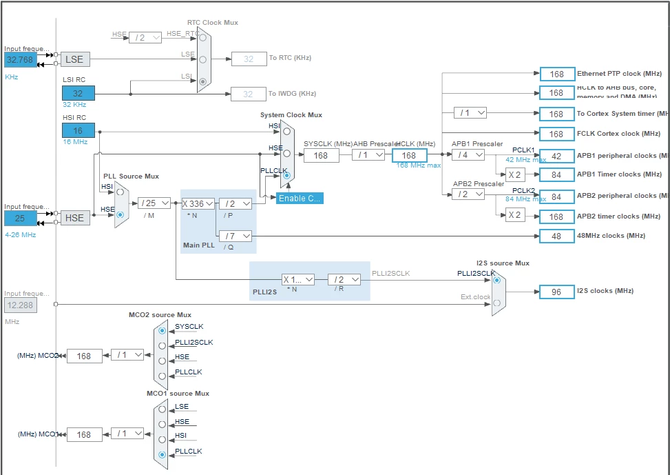

Greetings,
I have purchased a Clicker2 from MikroElectronica mainly because it has the facility to host their Click Boards ecosystem while working with the STM32CubeIDE. I can't say that I am a fan of their abstracted SDKs and code that is too dissimilar to that of HAL and so on. The issue I am having is with the clock configurations.
The Clicker2 features a 25 Mhz Oscillator that I am certain is for the HSE and also features a 32.768 KHz oscillator that I am certain was meant for the LSE. Leaving all the specs as factory as possible (using the the internal oscillators) in CubeIDE I can get code to work as expected. However, I would like to set the MCU at 168 Mhz (not sure that makes any difference yet).
As an expeirment, I used the 168 Mhz settings in the native MikroElectronica IDEs (which seems to set HSI instead of HSE) and it all works. But they do a really good jobs of abstraction and therefore I can not ascertain how they set it all up.
Here's my attempted settings in the CubeIDE:
I2C2: I2C (Facilitates the MikroBus 2 position)
I2C3: I2C (Facilitates the MikroBus 1 position) (Conflicts with RCC MCO1 on PA8 when enabled)
RCC HSE: Crystal/Ceramic Resonator
RCC LSE: Crystal/Ceramic Resonator
RCC MCO1: Checked
RCC MCO2: Checked
No matter what I do, I am missing something and I can't get it to run on 168 MHz as it does in the native MikroElectronica IDEs. I have tried bypassing HSE, Using HSI instead at /16 all to no avail. Would anyone be willing to guide me to a solution?

hi,
how you test the core speed ? what its doing with your clocktree in pic , should run 168M ?

Hello
First of all, try without MCO1 / 2 enabled, since with quick look doens't make sense to drive clock these empty lines.
Have you debug it thru SWD etc or how you know its running or not ?
Br J.T
July 25, 2023
I don't have a programmer yet. Currently loading Hex files and using a HID Bootloader to upload code. So I can't tell if its running. I tried without MCO1 MCO2 enabled and it has no effect.

Ok, but the led is not blinking in PE12 with 168MHz ? and lower freq -> led blinks ?
Can you share also your ioc file ?

Hello
Try to comment out MX_SDIO_SD_Init(); or remove it from CubeMx. Does it affect to your problem ? It seem to end up to error handler if SD card not present.
Br J.T
July 26, 2023
I have started a whole new project for sanity and did everything possible to ensure that SDIO is not enabled or mentioned anywhere in the code/IOC files. I set the device up once again using the 25MHz oscillator and the needed factors for a clock of 168MHz and still not working. Hmmm...

Hello
I guess there is nothing wrong in your ioc- file.
Could you give more information how know its not running, or is it running with HSE crystal if you decrease freq from 168 Mhz to lower.
How you load your program to MCU, are you using mikrobootloader with works with some custom USB-HID bootloader ?
