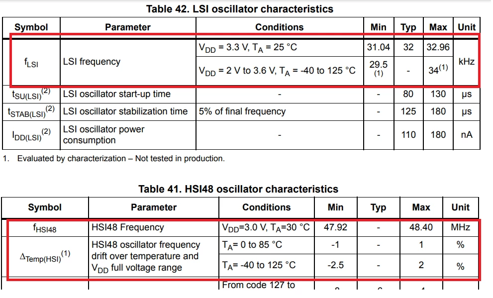

I am using STM32C031C6 evaluation board. I am using ADC_IN1 for the ADC measurement. I want to use internal clock source for my board. I want a stable ADC output.
1. Which internal clock source should I choose for the stable ADC output?
a) HSI48 (48 MHz)
or
b) LSI (32 kHz)
STM32C031C6 has sampling rate of 2.5MSps. I am going to use less samples. I want a stable ADC output.
Kindly give your suggestions and answers. Thanks in advance!

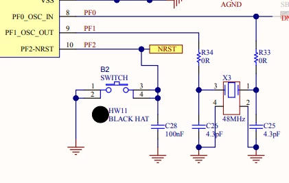

HSI48 , or (best) HSE (also 48M).
Mar 15, 2024 11:23 AM UTC
Thanks @AScha.3 !
Unfortunately, I want to use Internal Clock Source. HSE is an external source.

Use the default 48 MHz HSI48.
What do you mean by stable? how much?
According to the STM32C031 datasheet these clock sources jitter depends on the voltage and the temperature.  So you need to assess this "stability" according to your final product environment/needs.
Mar 18, 2024 3:07 AM UTC
The table shows the frequency produced by the oscillators and its characteristics.
I want to measure accurate voltage given to ADC_IN1 pin. The measurement should be accurate and stable.
