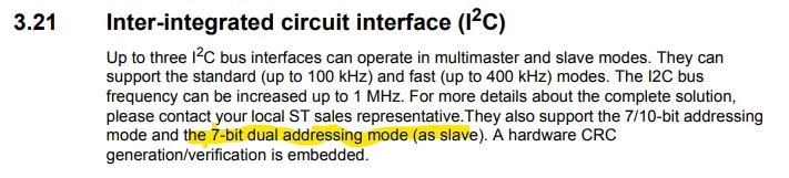

Hi.I work on BMS. I want a master-slave topology. I want to use 300 slave cards and 1 master card. This BMS is for automotive. I check ST MCU. I guess, The card should be 10-bit I2C. Because I want 300 Slave cards. So, Can you Help me this subject? Which one I will choose?
TDKBest answer
September 15, 2023
The highlighted portion says 7-bit dual addressing mode. So dual addressing mode isn't possible for 10-bit addresses.
Standard 10 bit addressing is supported.

Actually yes I saw that there is 10-bit I2C. However, when I read this sentence in the Datasheet, I got confused.
It says 7 bits for slave mode. I wasn't sure about this. So (this datasheet belongs to stm32F411) when I address it as 10 bits, I can connect 300 Slave devices together, right? Will there be a problem? And I checked the page you send.

ok thank you. I missed the dual text
