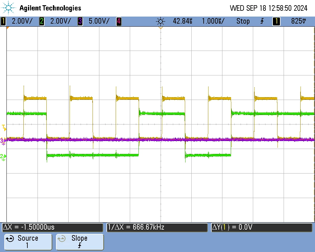

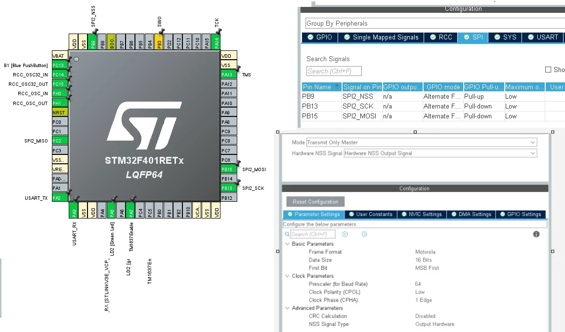

I m having an issue with my Nucleo F401RE. I m porting a code based on the use of SPI2 that worked very well on Nucleo G431RB. I made same setting on Nucleo IDE (see picture).
After inizialization of periperhals NSS (Chip Select) goes to high and everithing seems to work fine until the first transmission:
void SPI_TX_16b(uint8_t* pdata){
	HAL_SPI_Transmit(&hspi2, (uint8_t*) pdata, 1, HAL_MAX_DELAY);

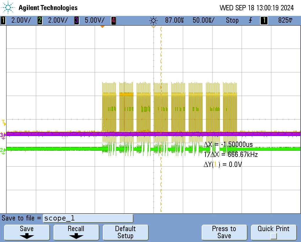

Then the NSS goes down and stucked there forever. In the picture (yellow is clk, green is data out, and violet is nss).

Don't use the hardware NSS pin on the STM32F4, it's not driven like a CS pin. It will always be low when the peripheral is active. Instead, initialize it as a GPIO output and manually set it low before transmission, and high afterwards.

But why the IDE mentions "hardware NSS output signal" if Chip select is not automatically managed? In G431RB used to work automatically

Different chips have different SPI peripherals and they behave differently. This is how it behaves on the STM32F4.
Why? Who knows, but newer chips behave differently so it feels like they recognized the issue. Just what it is. Keeping CS low is sometimes not a problem.
