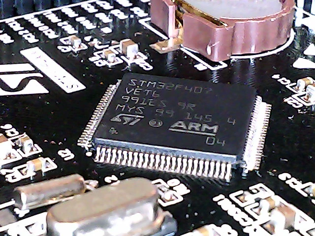

I've got a few of the Aliexpress Chinese STM32F407VET6 development boards that arrived recently. I became suspicious when the content of 0x1FFF7A22 is reported as 0xffff, when it should be the flash size in KB. The MCU chip itself reads:
STM32f407
VET6
991ES 9R
MYS 99 145 4
ST e3 ARM
04
Note that there's no revision number, which immediately made me suspicious. The MCU at first blush, seems to work okay, but what should I be aware of if I should try to use it?

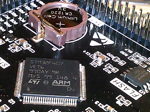

chuck guzis
Nov 29, 2022 5:38 AM UTC
Here's a photo. I also have some with the 06 marking. What perplexes me is the 0xffff read from the flash size register. It also seems to confuse OpenOCD, which defaults to 1024K flash size. A known-valid STM32407VET6 reads 0x200 in the same location.0693W00000WJhoAQAT.jpg
Tesla DeLorean
Guru
Nov 29, 2022 8:35 PM UTC
This has different markings than you mentioned earlier.
Does this have the boot loader and Flash size as 0xFF ?
The OpenOCD app should identify the Core, and that's usually different for CKS vs ST
chuck guzis
Nov 29, 2022 9:01 PM UTC
On the one I initially reported:
openocd reports Info : device id = 0x10076413
memory at 0x1FFFF000: 0xffffffff
flash size = 0xffff
On the one in the photo, same device ID, but flash size register is 0x200.
I'll attach a photo of the one I initially reported a bit later...
I should note that both came from the same shipment.

chuck guzis
Nov 29, 2022 8:46 PM UTC
The type font looks more like what one sees on the Gigadevice GD32F407VET6--sort of an OCR-A.
What with the chip shortage, I wonder how many "clone" manufacturers are taking advantage of the situation...

chuck guzis
Nov 29, 2022 10:38 PM UTC
Here's a photo of the MCU that shows 0xffff for the flash size. While it seems to work, I'm going to swap it out for one that reports flash correctly. I don't need another thing to worry about. What's notable on this one is how "ARM" is quite visible from a distance, but the rest of the chip labeling is a bit faded.
