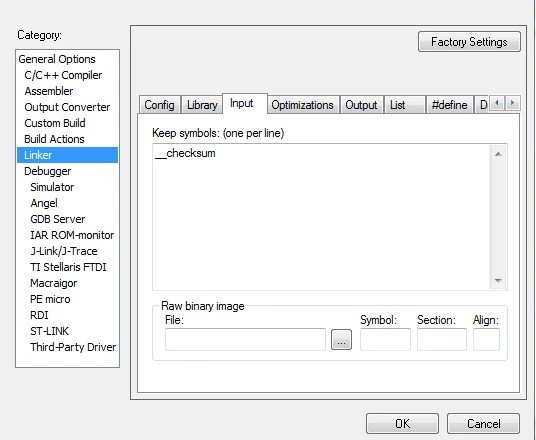

I am following the steps in this tech note and I stuck here:
Add usage of the symbol __checksum in your application
In fact I don't understand what does mean ''add usage of the symbol......''
When I declare it as following:
unsigned short __checksum;
I got thsi error message:
Error[Li006]: duplicate definitions for ''__checksum''; in ''C:\.....\checksum\Obj\main.o'', and ''Place holder __checksum''
When I declare it as following as done in the example provided by IAR:
extern unsigned short __checksum;
I got this error message:
ielftool error: The string '__checksum' was not found in the string table
Is there someone who can help me on this? and thank you in advance.

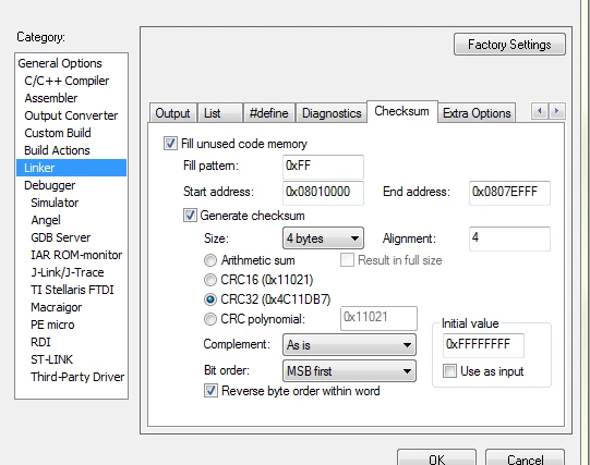

    tbenson
    August 9, 2011
    Posted on August 09, 2011 at 18:47
    Here are the settings I used in IAR to get the checksum to match the STM32-generated one (note that your addresses will be different depending on your application):
    Also see http://supp.iar.com/Support/?Note=11927
    lowpowermcu
    August 9, 2011
    Posted on August 09, 2011 at 21:39
    Hi benson,
    In ''http://supp.iar.com/Support/?Note=11927'' I don't understand what does mean ''add usage of the symbol......''
    How did you get off of it?
    Thank you

    tbenson
    August 9, 2011
    Posted on August 09, 2011 at 22:54
    Make sure you add the __checksum symbol to the Input dialog as shown below:
    I'm heading out for vacation now, so good luck :)
