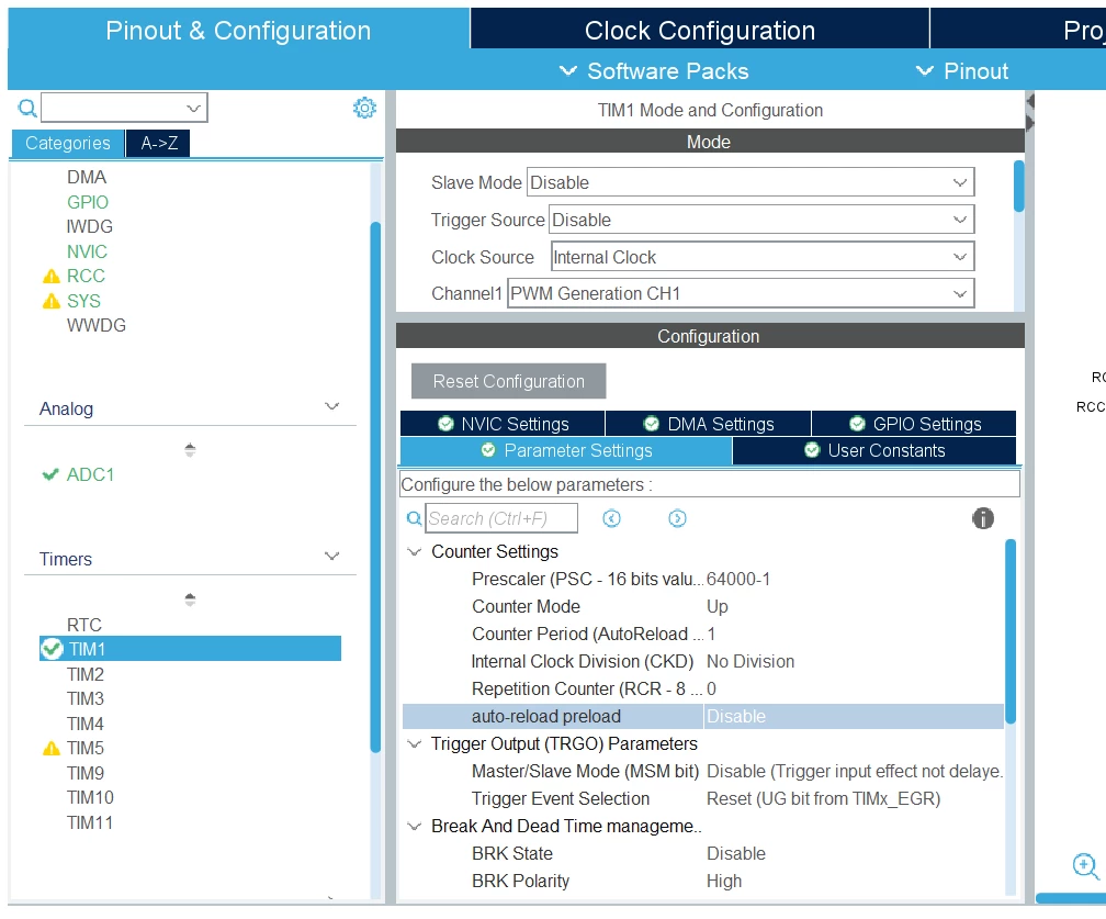

Hi everyone, I am trying to generate PWM signal and change it's frequency with a potentiometer. I have connected an LED to the PWM output and it blinks only a few times and then stops. Sadly, I don't have an osciloscope to check the signal.
I am using Black Pill with STM32F401CCU6 chip.
Here's my code:

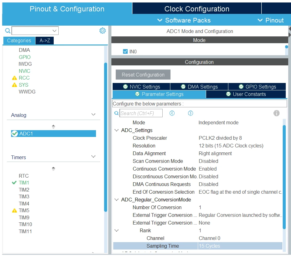

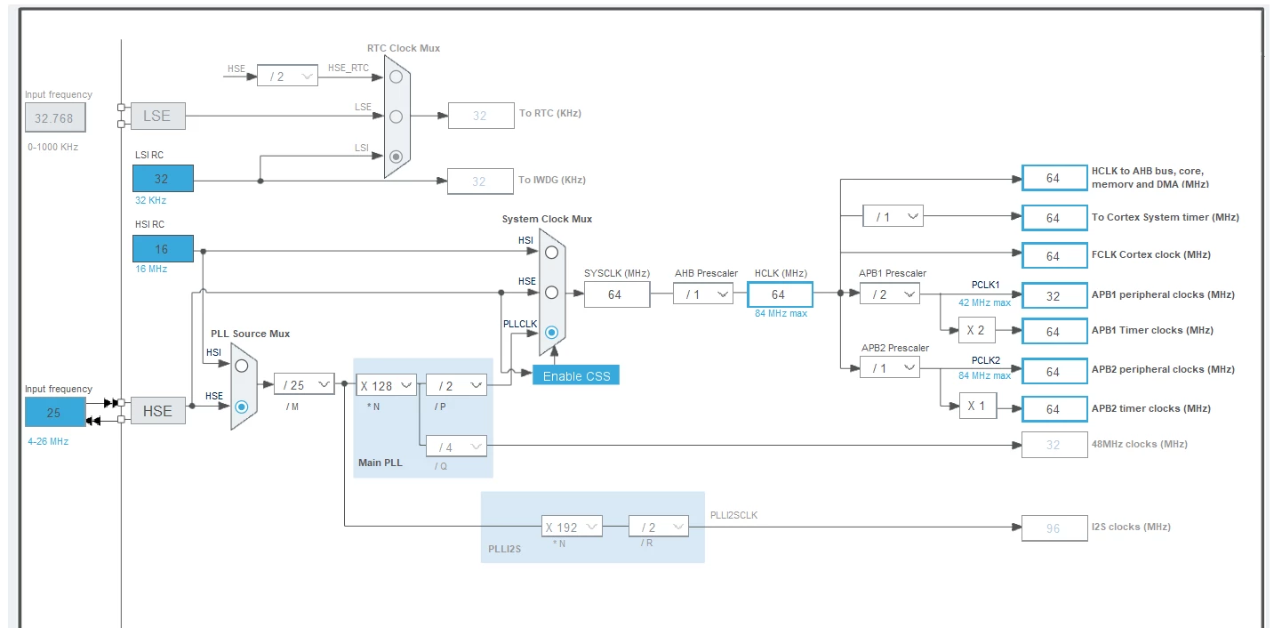

also I have attached files with timer, adc and clock configuration. I hope someone can help me out.
TDKBest answer
October 27, 2023
Swap your timer prescaler and autoreload values.
7 replies
TDKBest answer
October 27, 2023
MS.23
MS.23Author
November 1, 2023
So I've tried your suggestion and instead of changing ARR register I changed the prescaler value by using
__HAL_TIM_SET_PRESCALER(&htim2,newValue);
Now it works flawlessly, thank you.
