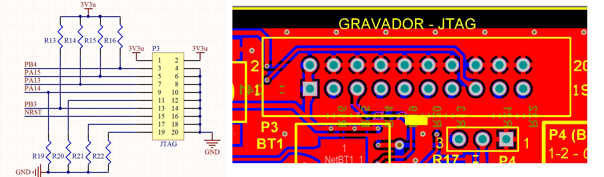

I tried to change my program from STM32F207IG to STM32F207IF and I have fail.
In options for target I have changed the device to  STM32F207IF.
Then I go to Options for Target -> Debug -> Settings -> Flash Download. There's no option to stm32f2xx
with 768 Kbytes Flash.
So I have to change another thing like the memory start and size? I tried to program and receive SWD Comunication Error.
I dont know if the problem is with my PCB or the program.
Thanks for reading.

    On your board check your programming header, make sure connectors aren't backward, or pins mirrored, or interleaved incorrectly (ie 1,2,3,4 vs 1,3,5,7). For SWD you minimally need the two SWD pins (SWCLK/SWDIO), GND and NRST, optionally the SWO(JTDO)
    felipe
    felipeAuthor
    June 7, 2013
    Posted on June 07, 2013 at 18:39
    It seems ok to me the header and the pins.
    The pins numbers are right with the datasheet.

    That doesn't appear objectionable.
    Bridged connections would be something to watch. Excessive heat might cause latent failure, but I'd discount this until I'd done some more general testing. Have a couple of boards built.
    Have you confirmed the chip is functioning?
    Check the Digital, Analogue and Battery supplies. VCAP pins at ~1.25V. NRESET High.
    Check System Loader, BOOT0 High send 0x7F to USART1 or USART3 at 9600 8E1 (Even Parity, important), check for an 0x79 response.
