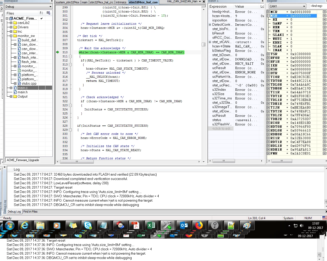

Changes required in the CAN configurations for stm32f413xx, since the below configurations in the code is not working

void MXCAN1Init(void)
    __HAL_RCC_CAN1_CLK_ENABLE();
    stat_stCAN_HandleTypeDefHCan1.Instance = CAN1;
    //stat_stCAN_HandleTypeDefHCan1.Init.Prescaler = (U16)((U32)HAL_RCC_GetPCLK1Freq() /
    //                                                     (16U * CAN_BAUD_RATE_BPS));
    stat_stCAN_HandleTypeDefHCan1.Init.Prescaler = 16;
    stat_stCAN_HandleTypeDefHCan1.Init.Mode = CAN_MODE_NORMAL;
    stat_stCAN_HandleTypeDefHCan1.Init.SJW = CAN_SJW_1TQ;
    //stat_stCAN_HandleTypeDefHCan1.Init.BS1 = CAN_BS1_8TQ;
    stat_stCAN_HandleTypeDefHCan1.Init.BS1 = CAN_BS1_6TQ;
    //stat_stCAN_HandleTypeDefHCan1.Init.BS2 = CAN_BS2_7TQ;
    stat_stCAN_HandleTypeDefHCan1.Init.BS2 = CAN_BS2_8TQ;
    stat_stCAN_HandleTypeDefHCan1.Init.TTCM = (U32)DISABLE;
    stat_stCAN_HandleTypeDefHCan1.Init.ABOM = (U32)DISABLE;
    stat_stCAN_HandleTypeDefHCan1.Init.AWUM = (U32)DISABLE;
    stat_stCAN_HandleTypeDefHCan1.Init.NART = (U32)DISABLE;
    stat_stCAN_HandleTypeDefHCan1.Init.RFLM = (U32)DISABLE;
    stat_stCAN_HandleTypeDefHCan1.Init.TXFP = (U32)DISABLE;
    if (HAL_CAN_Init(&stat_stCAN_HandleTypeDefHCan1) != HAL_OK)
        ErrorHandler();

    You are not providing many details about your issue.
    Can you clarify more your problem?

    The code is entering the while loop and getting stuck there in stm32f4xx_hal_can.c file....the image for the same is provided below0690X00000609CtQAI.png
