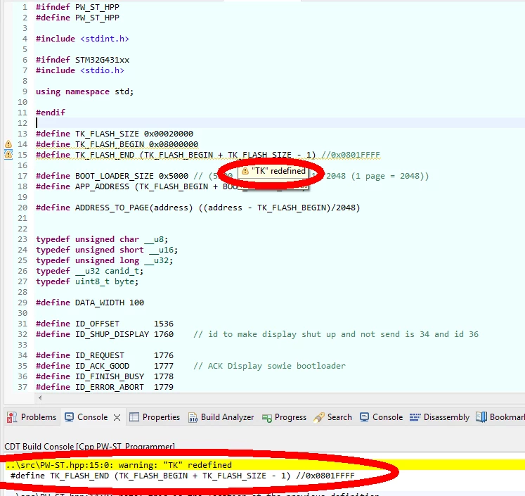

Changed a few #define -> cube IDE goes nuts.
How in the world is this happening now? Just made some changes there. Renamed and changed the values.
The first line has "missing whitespace after the macro name"

Found it: There were special (invisble) chars in there!
I used find and replace. How could that get in there?

There may be some nonprinting character between the characters you see, and/or the underscore may be a different Unicode character, which prints as underscore but is not recognized as underscore.
Rewrite the given lines manually, don't copy/paste.
