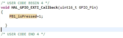

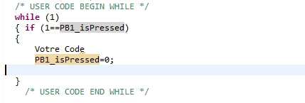

I am implementing an application when I need to set high a status variable when a button is pressed. I would like to do so via the interrupt routine of the push button. So, in gpio.c I have
void HAL_GPIO_EXTI_Callback(uint16_t GPIO_Pin){
 if (GPIO_Pin == GPIO_PIN_0){
 PB1_isPressed = 1;
In the main.c I would like to have a statement like:
if (PB1_isPressed ==1){
do something
Now my questions are the following:
  1. Is this a good practice?
  2. where do I declare PB1_isPressed? and how?
Sorry for the very basic questions and thank you all for the help in advance :)

Hello again,
Thank you for your explanation!
So first of all, declare your variable (PB1_isPressed) which will be changed within the interrupt routine in Private variable section (View photo attached)
uint8_t PB1_isPressed=0;
0693W00000VOgqQQAT.pngNow in while(1) : implement your code in case PB1_isPressed is set.
Setting PB1_isPressed will be done in the Interrupt routine.
0693W00000VOgqkQAD.pngFinally, set your variable in the Interrupt routine
0693W00000VOgrEQAT.pngI hope that answers your question!
Thank you!
Sarra

Hi your question isnt STM based. Its basic C lang standarts.
For interrupt you need global volatile variable.
But in real hw situation , you need handle false pulse (ESD), too sw need sometimes handle push button down moment or pull up, long press etc.
Next situation is interrupt speed required. ? ... Then your q
  1. no good practice
  2. on stm Interrupt detection for buttons is required only whe low power modes is used and button wake MCU. Here use empty irq routine and test after wake gpio state in code...

You could use EXTI PR bit directly if polling from main loop... otherwise, use a volatile variable, set by interrupt and cleared by main loop. In theory, you should self disable the interrupt in case someone inject few MHz square wave to hang/break/hack your code with interrupts ddos style. What is simple at first gets refined down the road...

For correct code you have to speciify volatile for a variable shared between an ISR (callback) and application/task code. Otherwise it might get optimized out. The compiler can't know that the variable might get changed by an ISR and might assume it's constant..
