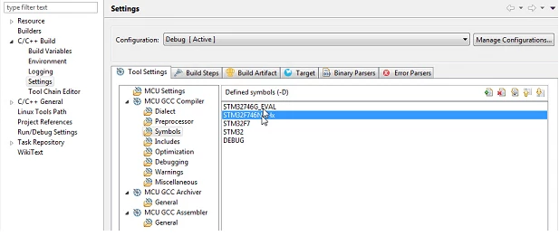

I use the SW4STM32 IDE and would like to create a generic static library.
When I go to New Project tab and select static library in ''Project type'', I can create ''Ac6 STM32 MCU GCC'' or ''Cross GCC'' project.
Naturally I go to the Ac6 project and then I have to select  the target MCU.
The problem begins, when I want to change the target MCU. There is a warning not to do that, and even if I try to change the target in the settings, the target won't change.
The advice is to create a new project, but that would be difficult if I want to use the library on many projects.
I think I could create GCC project by referencing the toolchain and everything else, but it looks like an inefficient way.
I would like to ask if there a good way to change library target device?

    Posted on September 22, 2016 at 17:21
    Hi heifets.gregory,
    The warning appeared is normal to take you aware that some workspace related configuration ./setting should be changed too. Check the following :
    * Update the symbols inside the setting panel to make your project portable on the new device (see figure below)
    * Check if you have any defines/preprocessor on you code that should be updated with new device
    * Ensure that your static library totally support new device.
    Good Luck
