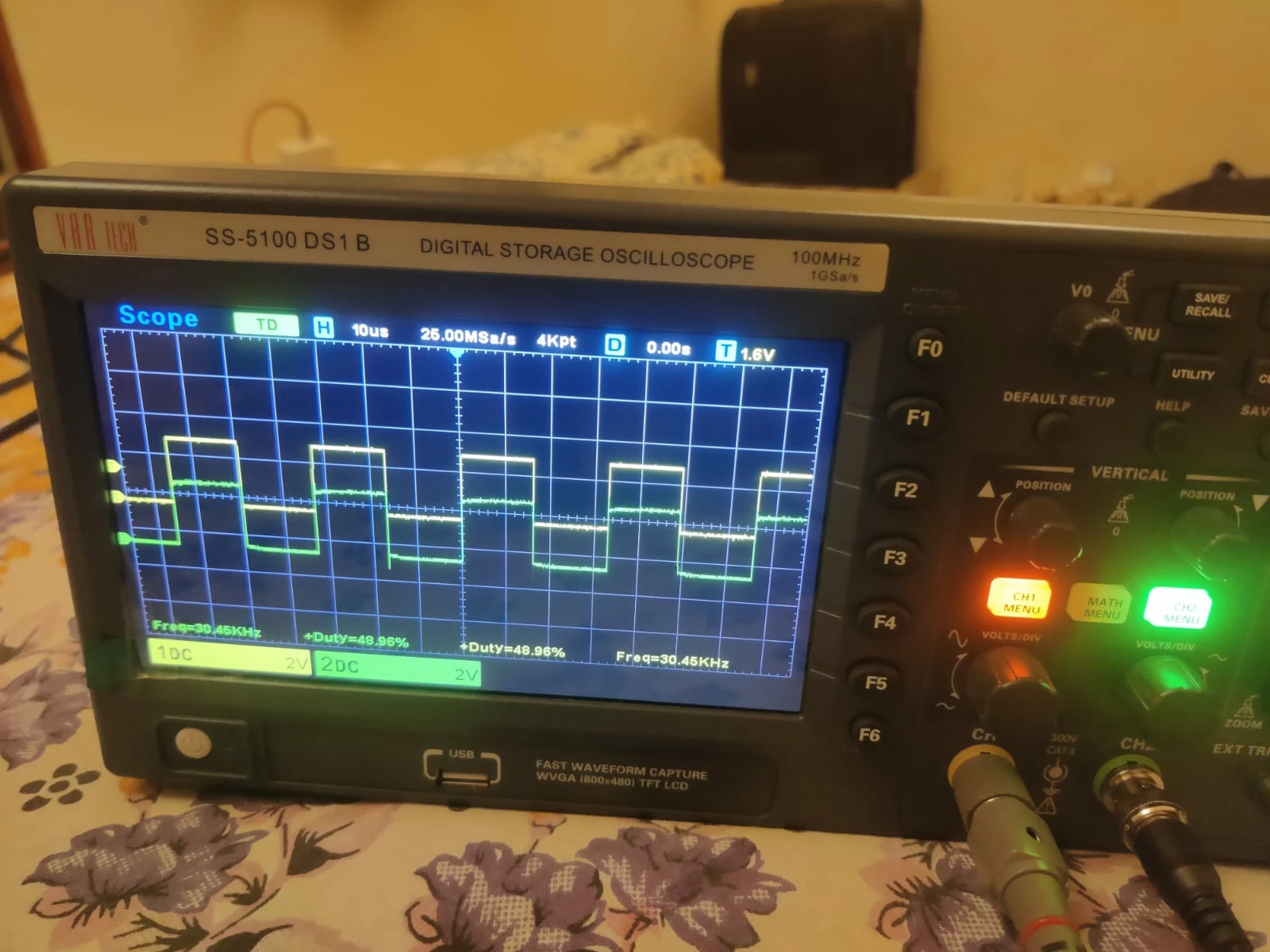

I'm working on a PSFB converter project and need to generate 4 PWM signals. Currently, I'm using TIM1 CH1 for complementary PWM with dead time inversion, and TIM1 CH2 as a master to trigger TIM8 CH1, also configured for complementary PWM with dead time inversion in slave mode. I've managed to achieve an accurate phase difference between the signals, but I'm struggling to change this phase difference during runtime or in real-time. In the TI C2000 series, there's a separate register for adjusting the phase difference on the fly. I'm curious if there's something similar in STM32, allowing me to program and adjust the phase difference dynamically. Any insights would be appreciated!
I can also change my microcontroller series, if required.
My code

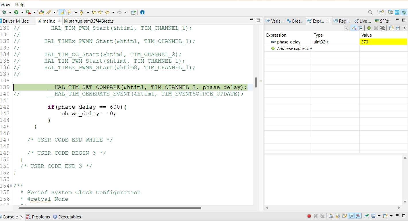

Hello @suyog800, welcome to ST Community,
Here's an example of how you might adjust the phase for TIM1 channel 2:
// Calculate the new CCR value for the desired phase shift
uint32_t new_phase_value = ...; // This should be calculated based on your requirements
// Set the new CCR value with preload enabled
__HAL_TIM_SET_COMPARE(&htim1, TIM_CHANNEL_2, new_phase_value);
// Optionally, force an update event to update the CCR register immediately
__HAL_TIM_GENERATE_EVENT(&htim1, TIM_EVENTSOURCE_UPDATE);
In your code, you are already using `__HAL_TIM_SET_COMPARE` to set the phase delay for TIM1 channel 2. If you have enabled the preload feature for the CCR registers, this should allow you to adjust the phase on the fly. However, if you are not seeing the phase shift as expected, make sure that the preload feature is enabled and that you are calculating the new CCR value correctly based on the timer's settings.

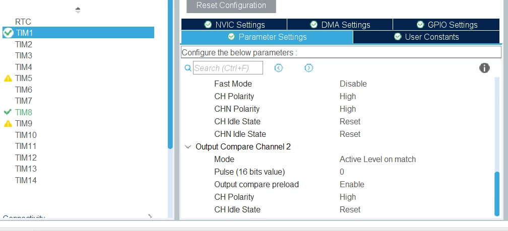

suyog800Author
April 8, 2024
@Sarra.S
As you can see, I have enabled preload feature for the CCR registers.
In the initialisation below, you can see that I am starting the signal with zero phase shift.
sConfigOC.OCMode = TIM_OCMODE_ACTIVE;
sConfigOC.Pulse = 0;
if (HAL_TIM_OC_ConfigChannel(&htim1, &sConfigOC, TIM_CHANNEL_2) != HAL_OK)
Error_Handler();
In the run time, I am updating the value as required, but there is no change reflected in the signal.
in the above image, you can see the phase delay value in the debug perspective. But no change in the output signal as shown below.
 Also,
not a valid function for F4 series I guess.
I did a little debuging by proabing TIM1 OUTPUT COMPARE pin , and found out that, once the pwm is started running(HAL_TIM_OC_Start(&htim1, TIM_CHANNEL_2)), it is never pulled down(remains always high). Therefore the phase difference is not getting updated.
Can you please provide me some solution. I am stuck here for many days!!!
